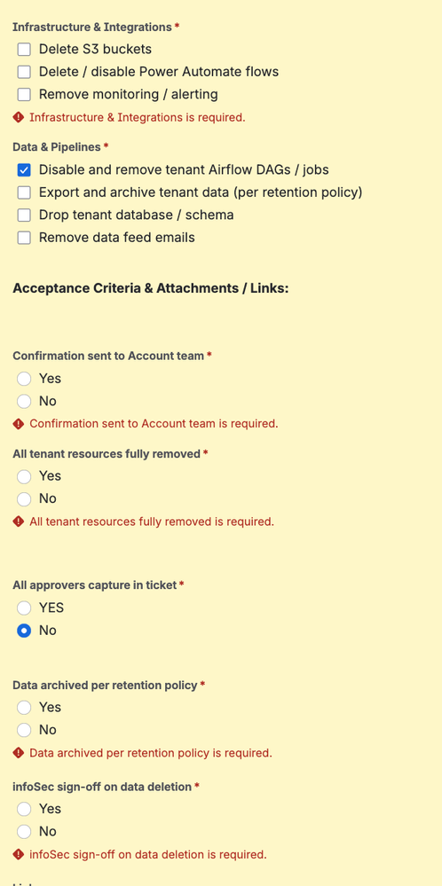

the more fields should not show in issue layout after ticket raised and in the form required option that highlighting with red one should not show any solution for this .image (31).pngimage (32).png

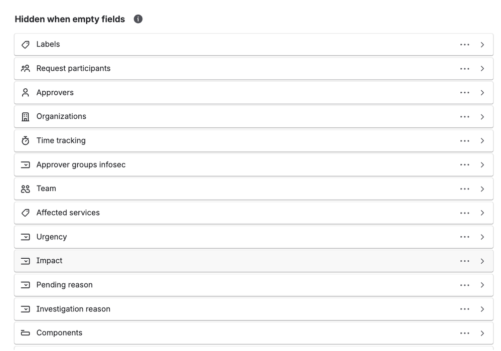

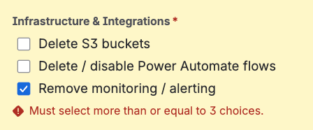

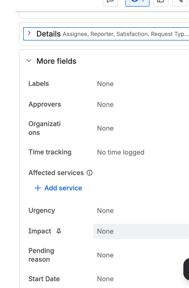

Hi @VENKATESWARLU KURUVA ,thanks for response ,already they are in Hidden when empty field below image for reference and the required field must be selected but it should not show like this red mark "Must select more than or equal to 3 choices" if not selected all

Hello @Abilash
"Hidden when empty" just bumps the field into the "More fields" dropdown. To get rid of it completely on the issue view, you must drag it down to the actual "Hidden fields" section in your issue layout settings.
The red error are another story and it means a Form or field validation rule requires at least 3 choices. You can't hide a field that's actively breaking a validation check, Jira has to show somehow what's blocking the save😉 You'll need to either lower that minimum requirement or make the field/question optional.

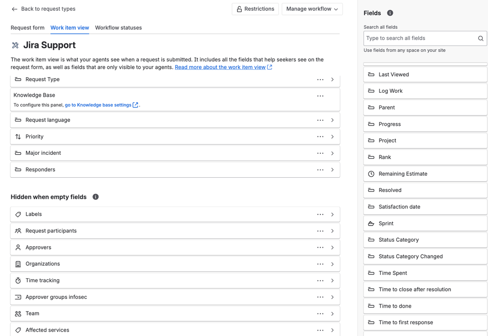

@Arkadiusz Wroblewski ,Thanks for your response.how to to move it to hidden section,just to drag them to right side.it may effect any issues to other requesimage (36).png
