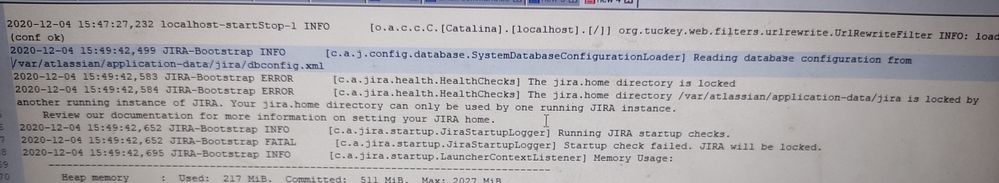

Hi ,
I am getting these error at the time of stating jira.
May you please recommend that how to check whether another running instance of jira is running or not on ubuntu server. I am stucked on this.
Please suggest on same. I am using jira 8.2.3 that is on ubuntu os.
