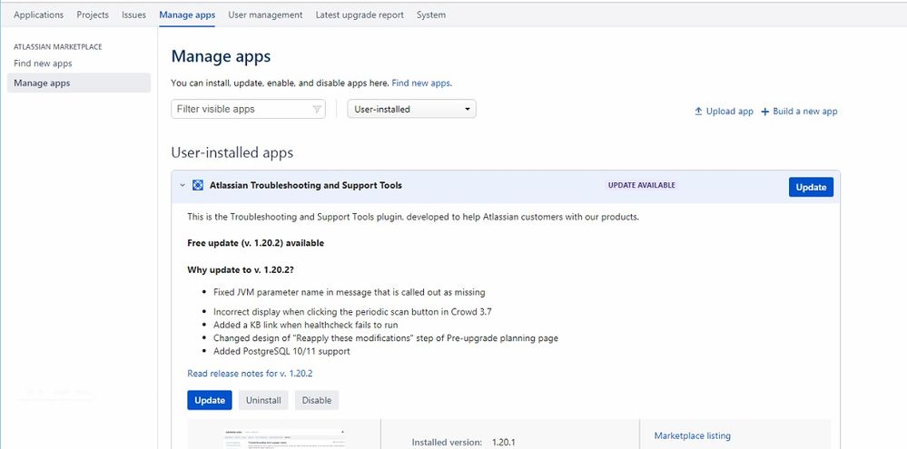

In fact, this is a very "fresh" installation, and we have only the Atlassian Troubleshooting and Support Tools installed (see attached image).
According to my feelings, the problem is related to some misconfiguration of some Jira topics.
We can try your suggestions only at the beginning of next week, so I ask you to wait some time for our reply. But I guess it will make no difference at all, once we only have this single app installed.

I doubt that particular plugin is the source of the problem here.  I would be interested to see what the HAR file shows when trying to load that page.
