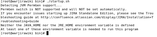

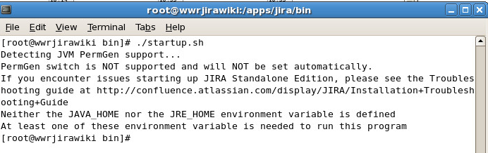

I see file called : startup.sh  in the Bin Folder, running that gives the that message:
searched online and created a script to point to JAVA and call the same file, but gets that error now !

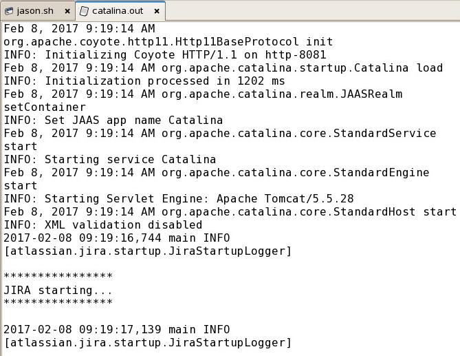

Ok, if there's nothing going into the <jira home>/logs, then the Tomcat is not getting as far as starting the application.
So, we need to look into <jira installation>/log directory for "catalina.out" and look at the end of that file to see why it's not starting.

thanks again for your answer, I see that catalinaout has only date from 2/2017, so looks like i'm not starting the services right.

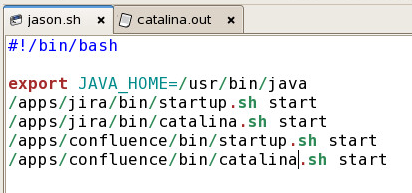

here's my script, i must be doing something wrong..

If you go to /apps/jira/bin and run startup.sh manually, then it should either error, or try to start JIRA and write to the catalina.out file.

when I do that I get the java error, that's why I created my script

Ah, sorry, I forgot, JIRA 4 doesn't have its own JRE.
The JAVA_HOME in your script is wrong, which might explain some of it.

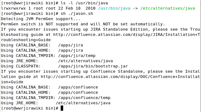

First run
ls -l /usr/bin/java
I expect it will say something like
java -> /usr/local/java_1.6/bin/java
You need to set the JAVA_HOME to be the path to the complete java installation, the directory above /bin/java.  (So in my example, you'd need JAVA_HOME=/usr/local/java_1.6 )
Also, your script is using the wrong start-up.  The JIRA start script already calls out to catalina.   You should remove both of your lines refering to catalina from the script.

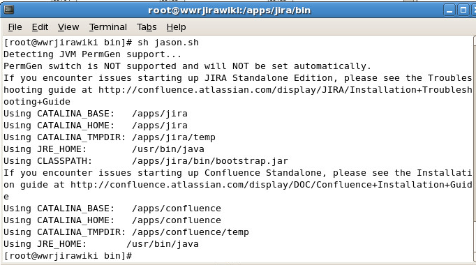

I did that, but still no luck. here's a screenshot.

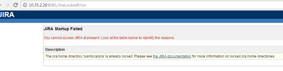

I changed it to /usr/java/default  and it started, but the header is blue, not red!! and also it's giving me an error.  see attached.
Afligo Afligo July 3, 2017
Nic, there's no .lock file exists at all !!  any idea?  looks like we're so close...thank you for all your help..

Stop all the Atlassian applications on the machine, then check the lock file is definitely gone, then try again.

I just restarted the whole server, checked the URL nothing works, started just "Jira "and same error message came up about the lock!! although there's no .lock file!!
it's showing in the error that "usr/local/jira" is being locked,  I'm running it as Root, maybe I need to run it this Jira user??   sorry I'm asuming there's a user called "Jira" ?! by looking at the error message...
