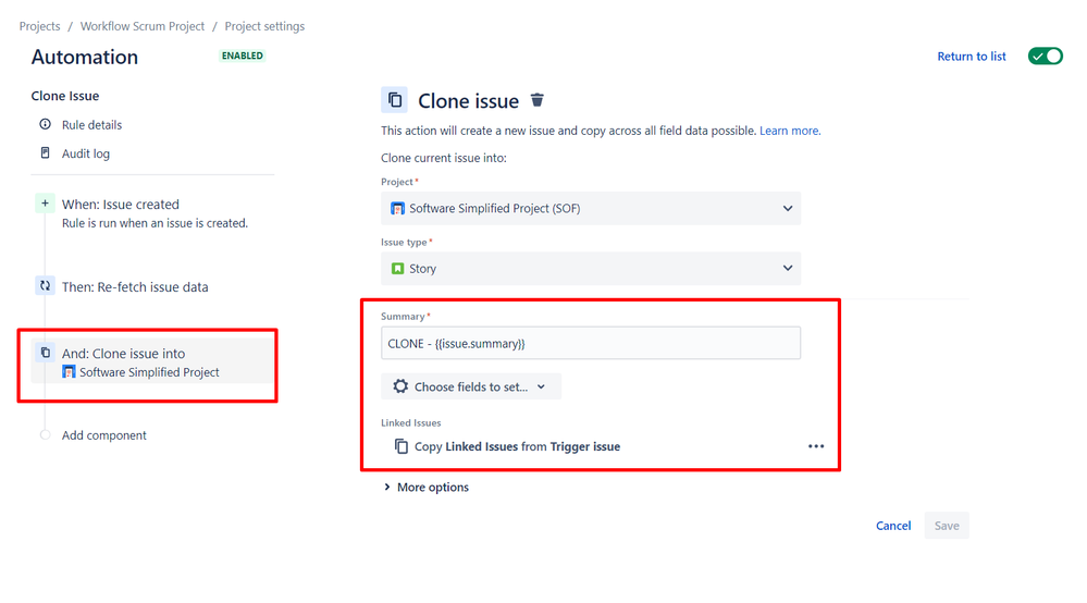

Assuming the problem is statement is below
I want the new issue to include all the links of linked-issues from the original issue.
Can you try the below and let me know
Thanks,
Pramodh
Pramodh M
January 30, 2022

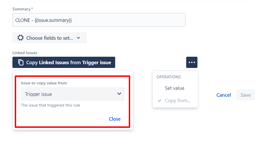

FYI, this is the option
Elyashiv Grosser
January 30, 2022
Hi!
I'm feeling so stupid, I didn't see that option.
Thank you very much!
I tried for a long time something with a such simple solution!
