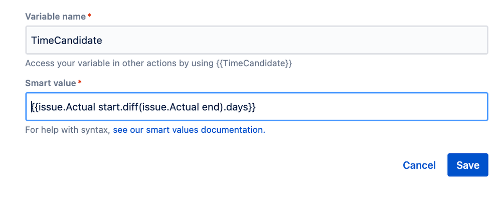

Ivan Andrieiev
October 14, 2022
Ivan Andrieiev
October 14, 2022
TimeCandidate is a created customize field.

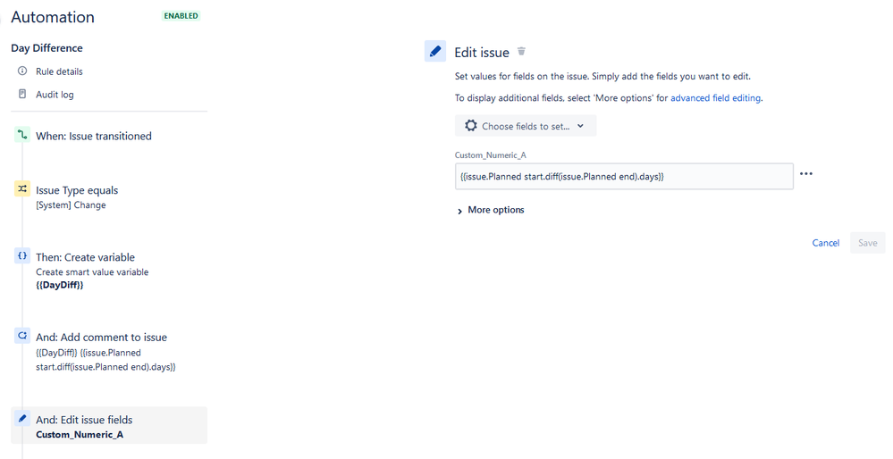

Below is the screenshot showing how the value of a custom field can be edited.
Kindly let me know if this works or if you have any further queries.
Please accept the answer if this helps.
--GG

Ivan Andrieiev
October 14, 2022
@Gaurav
So it worked thank you very much. I am very happy. There is simply a task to track how much time has passed from some customized date to the end date, and the end date is set before the task is already closed. Is it possible to count to specify dates in a different chav interval?
