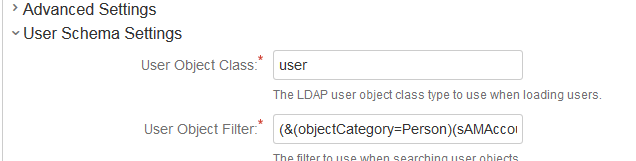

So i have created a filter to get only the user that are in the above mentioned groups. LDAP filter looks like this:
"ldap.user.filter": "
(&(objectCategory=Person)(sAMAccountName=*)
(|(memberOf:1.2.840.113556.1.4.1941:=cn=jira-core-users,OU=jira,OU=ourMainOU,DC=ourCompanyDc)
(memberOf:1.2.840.113556.1.4.1941:=cn=jira-software-users,OU=jira,OU=ourMainOU,DC=ourCompanyDc)))"
(the number behind membersOf is the LDAP matching rule OID, google it for more information)
that query has to be entered in your ad-settings in Jira in the user schema settings part in "User Object Filter":
