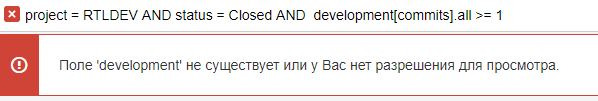

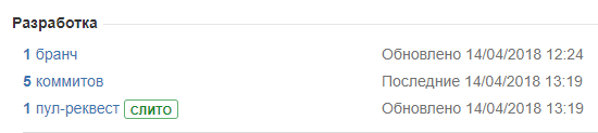

1.PNG2.PNGSee the field is, but in the query, it is an error that the field was not found or not accessed. Most likely this is an access problem.
Aliaksei Kozak
April 24, 2018
Разработка=development

Do you really have a numeric field called "development[commits].all"?
My instinct is that you are mistaking JQL for SQL, and it looks like you are trying to run code or a function for a development field, which is nonsense in JQL.

In the request itself this field is, and so I wanted to check through the settings whether this field is or not. And what's wrong with my request?

I'm sorry, not a request but a task. In the task itself there is a development field.

Ah, thank you, that clears up what I'd missed.  When you said "request", I was thinking "the way you landed in this place - a url with something mentioning 'development' in it".  You meant "request" as in "a Jira issue".  I should have seen that!
You say there is a development field in the request/task.  Can you tell us what the name of that field is?  Is it development[commits].all, or just development ?
Aliaksei Kozak
April 24, 2018
The field is simply a development called

Ok, so you need to search for the field development, not development[commits].all - that is not a valid field and is hence no use in JQL
