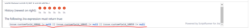

In the first pic there is the validator (issue.customfield_10046!= null || issue.customfield_10045!= null || issue.customfield_10059!= null )

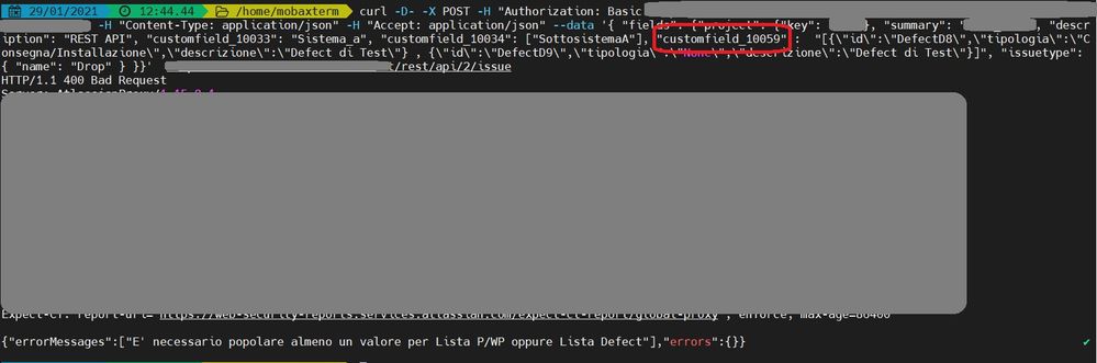

In the second pic there is the Rest API call, I have passed only the customfield 10059 and not the 10046 and 10045 and the Validator stop me, and Appear the error message

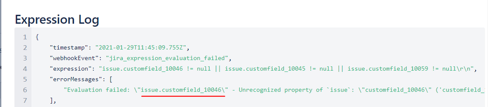

In the third pic you can see the validator log, that say that the customfield 10046 is necessary. But like you can see in the first pic I want only 1 of the 3.
I have noted that the required field is the first writed in the validator, if I change the order and I set the customfield_10045 in the first position of the validator, the error is that customfield_10045 is necessary, is like if the validator only see the first condition
