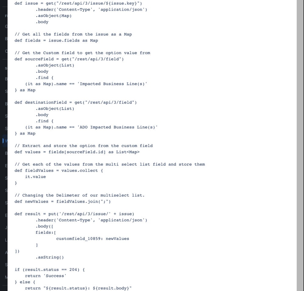

I’m getting the same error on my post function custom script but it works in the script console:
Disregard on my previous posting. I was able to solve this by removing the + issue part in my end point for the result variable and use the standard ${issue.key} variable to update the current ticket in question.
