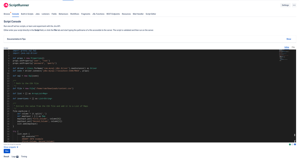

Please note that the sample code above is not 100% exact to your environment. Hence, you will need to make the required modifications.
Below is a screenshot of the configuration for your reference:-

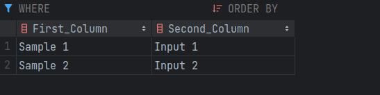

Below is a copy of the sample csv file I have tested with:-
Sample 1 Input 1
Sample 2  Input 2
And below is the output in the database:-
I hope this helps to solve your question. :-)
