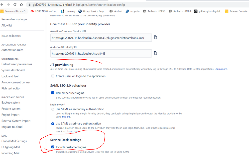

Hi team,
we already set up saml sso successfully both from Identity provider(ADFS) and service provider. cause we can direct access jira portal  successfully without login.
Then we want to enable service desk sso hence I check that box below Service Desk settings as you can see from picture.

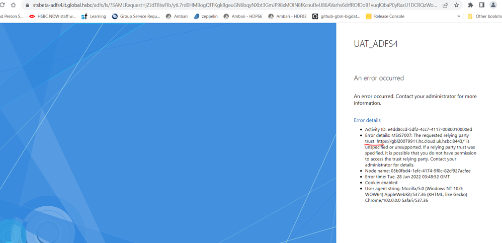

however when I access jira service desk portal by this link https://gbl20079911.hc.cloud.uk.hsbc:8443/servicedesk/customer/portals . I get this problem as picture2 shows.
my question would be , why it can work for jira portal
but can't work for service desk portal
according to this error , should I change the
Assertion Consumer Service URL or any other configuration from jira and Identity provider ?
below is the error I copy from picture 2:
  • Activity ID: 2d541cad-f3fb-4e6d-c203-0080010000e9
  • Error details: MSIS7007: The requested relying party trust 'https://gbl20079911.hc.cloud.uk.hsbc:8443/' is unspecified or unsupported. If a relying party trust was specified, it is possible that you do not have permission to access the trust relying party. Contact your administrator for details.
  • Node name: 05b0fbd4-1efc-4174-9f0c-82cf927acfee
  • Error time: Mon, 27 Jun 2022 09:25:01 GMT
  • Cookie: enabled
  • User agent string: Mozilla/5.0 (Windows NT 10.0; WOW64) AppleWebKit/537.36 (KHTML, like Gecko) Chrome/102.0.0.0 Safari/537.36
