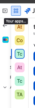

Chiming in...
While logged in to the site where you are trying to find the admin settings and Project Trash bin, click on the Your apps button in the upper left corner.
That will show a list of the Atlassian Cloud Organizations to which you have access. If you hover over the highlighted tile with the border showing ("Tc" in my image) then the name of the Organization should display.
Provide that information to Andy here to let him know in which Organization you are looking for and not finding the Admin options.
If you could still access the project you could use the same steps above to determine in which Organization its parent Jira instance resides.

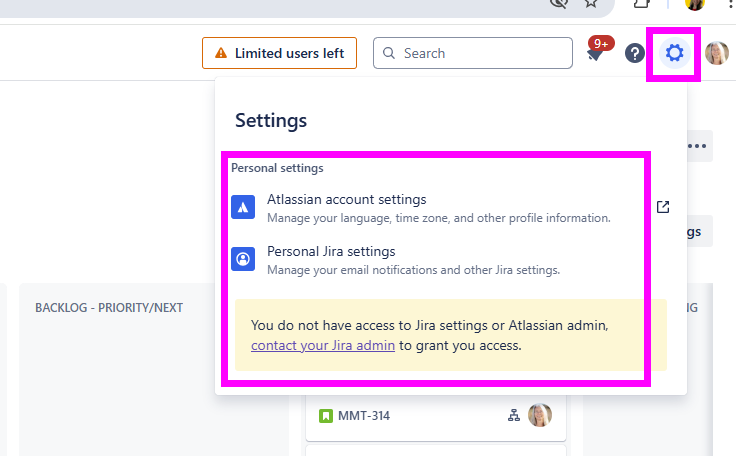

Absolutely I did, and absolutely no sign of Trash in the drop-down:
While you may be an Organization Admin, your account has not been granted the Jira Administrator (or Jira Product Administrator) level of access. If you had that access you would see more options like System, Projects, and Issues.

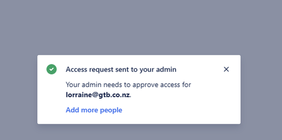

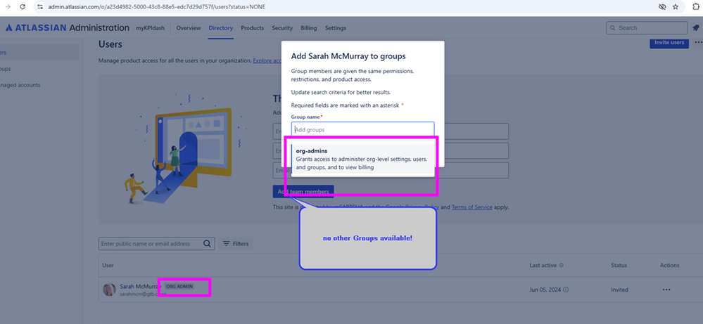

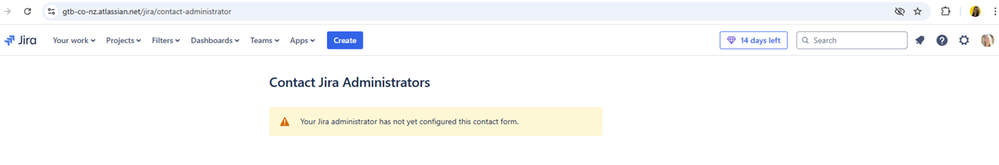

thank you @Trudy P Claspill - the information in https://support.atlassian.com/user-management/docs/give-users-admin-permissions/ to Grant access does not work - I just get this stone wall:
and when I Resend invite, NOTHING HAPPENS - no invite appears in Inbox, nor in Junk, nor Quarantine :-(

Note that this is a publicly accessible forum. You should obscure email addresses and full names.
This is a very strange scenario.

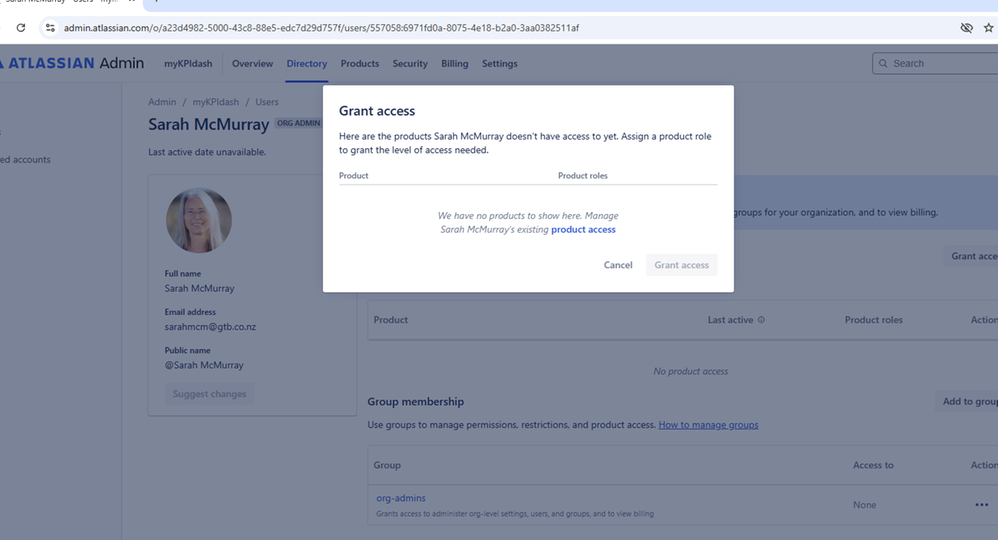

I see that you have another person specified as an Org Admin. Do they have the same experience as you?
If you drill into that user's account details, do they have any products listed? Are you able to grant them access to products?
