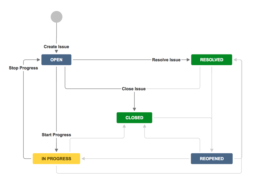

I create an issue that follows a workflow as shown below.

My questions are
- In the first response shown above, i expected "CLOSED", "RESOLVED" along with "IN PROGRESS". But, i get back only "IN PROGRESS". Why ?
- I expected the second response to contain "CLOSED", "RESOLVED" and "OPEN" but, it returns an empty array. Why ?
- Please explain the responses from this API
- What call should i have to make to the next possible transitions ?
Nic Brough -Adaptavist-
June 28, 2017
What conditions do you have on the transitions?
Rajkamal Subramanian
June 28, 2017
Thank you that helped. After removing the conditions defined on the transition i'm able to see the transitions in REST API.
