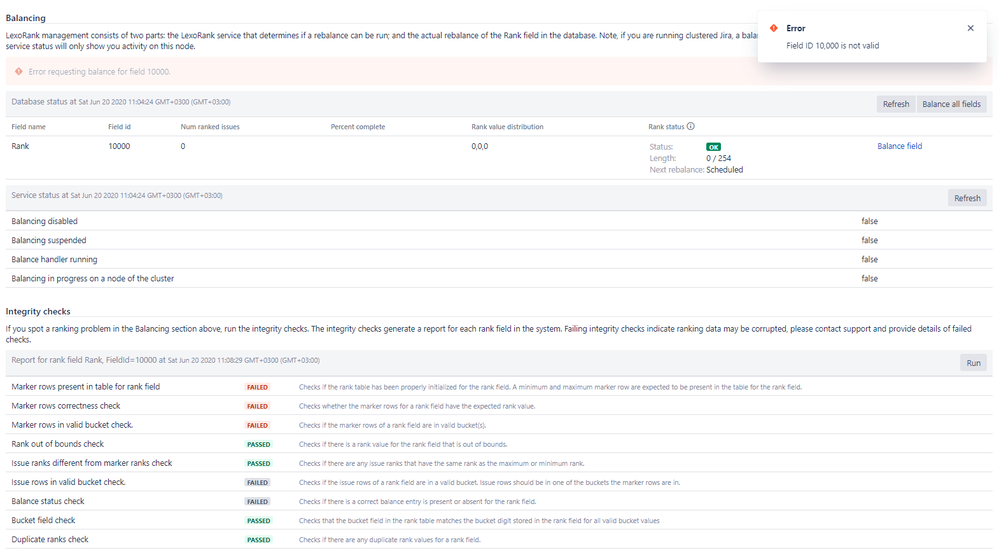

The error when balancing and the integrity check results are provided below. Note that we have several projects with hundreds of issues.Untitled.png

This looks like you have some quite severe corruptions in your database (probably limited to the ranking though)
I would want to tail the logs (read them as they are being written) as you try the rebalancing, the re-index and the integrity checks.  At least one of those (but probably all three) will throw errors into the logs telling us more about what is damaged.

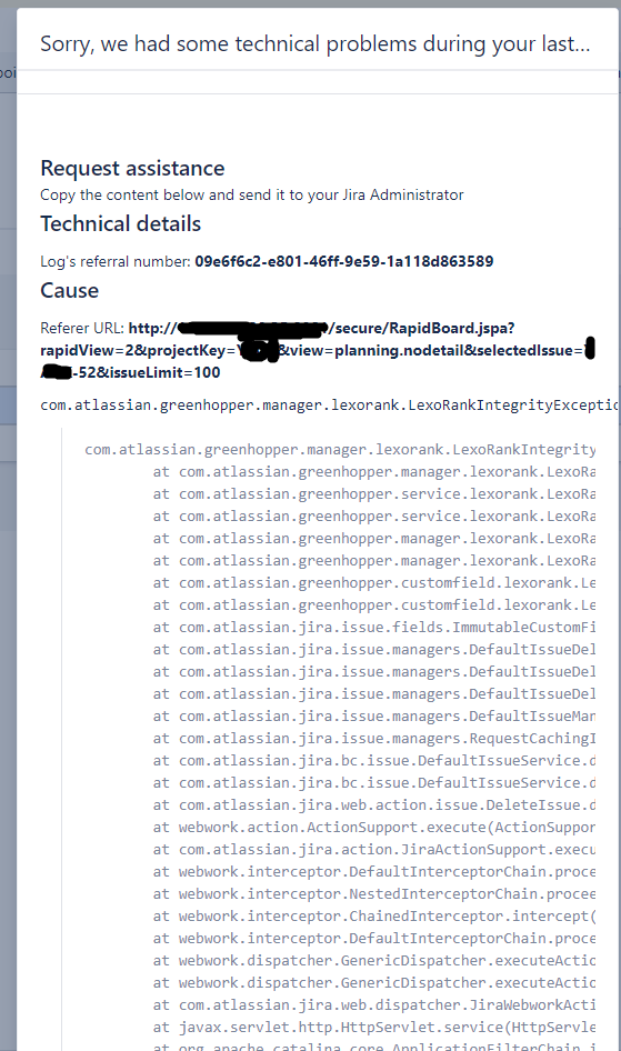

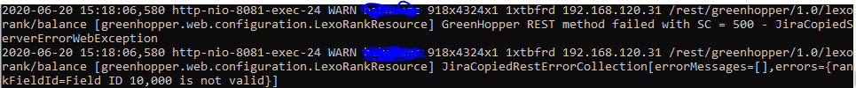

The log shows the following message when I try balancingCapture.PNGMoreover, when I try to delete an issue from the agile board, the following warning pops up and I cannot delete the issue.Capture2.PNG

We need to see all of the error, not a screenshot of part of it.
Could you give us the text of it please?  Both the on-screen and the log
