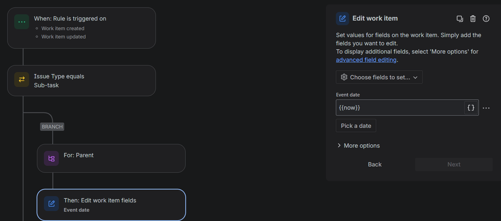

Hi Team,
We have a system field called "Update Date" (the actual field name is "Updated," which is located under the "Created" field). I have a requirement to update this "Updated" field whenever a sub-task is created or when any changes are made to the sub-task (such as field updates, status changes, etc.). This should ensure that the parent "Updated" date reflects the most recent changes of the sub-task. Is this a feasible requirement?
3 answers
Ana Livia Rocha Silva
September 29, 2025
Hi @jira_admin_cu,
Yes, that is totally possible. You can build an automation similar to the one below:
The trigger should be the creation and update of a ticket, followed by a condition to check if it's a Sub-task. Then you need a branch so the update is done to the parent ticket.
I hope I was able to help!
Kind regards,
Ana
