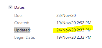

Hi,
When updating (manually or automatically) fields in a JIRA issue belonging to XRAY, the JIRA "Updated" (or 'updatedDate') field remains as it is. Like changing the status of a test run in a Test Execution (in my example below: FAIL to WAIVER).
This also happens on other issues I have tested like changing "TestRunStatus" field in a Test Template issue and so on.
So my problem is that we have a large reporting system that retrieves data from JIRA at intervals, and when I try for example to get all the Executions updated in the last hour, (That is 'updatedDate > xx:xx:xx'), I get unreliable and incorrect results.
Is there a way to fix this? or to provide me with a good solution for an indication of an update in the XRAY fields?
screenshots:
updatedDate field is 2:33 PM

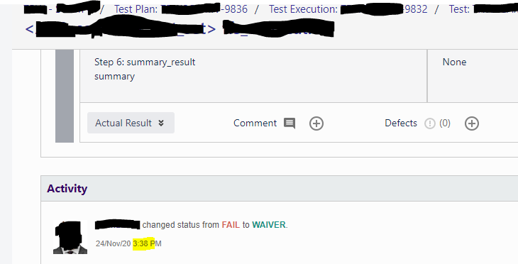

changed the test run status to WAIVER on 3:38 PM (as shown in the x-ray execution details view)
Nic Brough -Adaptavist-
December 3, 2020
I think this is because the "Xray fields" really are Xray fields, they are not Issue fields.
I think you might have to adjust your reporting, such that as well as using Jira's REST API to gather data, it also interrogates Xray's REST API ( https://docs.getxray.app/display/XRAYCLOUD/REST+API )
