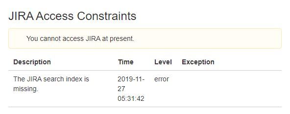

Hi All,
I am working on upgrading Jira for my project. So I replicated the existing Production instance ( v6.3.9#6) to make a dev instance and have pointed to DEV database that we already have for this upgrade. I brought up DEV Jira instance but while accessing I have getting "JIRA search index is missing error". Please let me know what I need to do for this error. My real intention is to upgrade our Production Jira to the latest.  So I am trying to create dev instance and upgrage before I touch Prod. Quick response is most most welcome,
Thanks,
Nitin.

I am assuming - there is a filesystem/path problem with your setup , can you verify your file paths ?
Your DB Config file is under ..../DEV/....
but your indexes are under ...../PROD/....
Is everything right out there ?
/opt/customer/Atlassian/DEV/Jira_Home/dbconfig.xml
/opt/customer/Atlassian/PROD/Jira_Home/caches/indexes]

019-12-02 00:53:14,074 localhost-startStop-1 INFO [atlassian.jira.startup.JiraStartupLogger]
___ Plugin System Started _________________
2019-12-02 00:53:14,308 localhost-startStop-1 WARN [atlassian.jira.scheduler.OfBizRunDetailsDao] Should not call getLastRunForJ
ob() when the scheduler is in standby; returning null for jobId=com.atlassian.jira.service.JiraService:10000
2019-12-02 00:53:14,421 localhost-startStop-1 INFO [jira.config.database.SystemDatabaseConfigurationLoader] Reading database co
nfiguration from /opt/customer/Atlassian/DEV/Jira_Home/dbconfig.xml
2019-12-02 00:53:14,430 localhost-startStop-1 INFO [jira.instrumentation.external.DatabaseExternalGauges] Installing DBCP monit
oring instruments: DatabaseExternalGauges.JiraDbcpInstruments[instruments=[DBCP_MAX, DBCP_ACTIVE, DBCP_IDLE],objectName=com.atlassia
n.jira:name=BasicDataSource]
2019-12-02 00:53:15,035 localhost-startStop-1 INFO [atlassian.jira.upgrade.ConsistencyCheckImpl] Checking JIRA consistency
2019-12-02 00:53:15,061 localhost-startStop-1 ERROR [atlassian.jira.upgrade.ConsistencyCheckImpl] Indexing is turned on, but in
dex path [/opt/customer/Atlassian/PROD/Jira_Home/caches/indexes] invalid - disabling indexing
