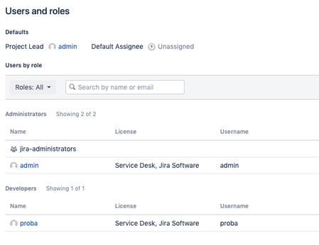

are the users member of the projekt role?
is the Project role assigned to the Project?
Tauqir Rao
October 15, 2019
No, the were not assigned. My mistake.
I have assigned project role to my project. Now its working

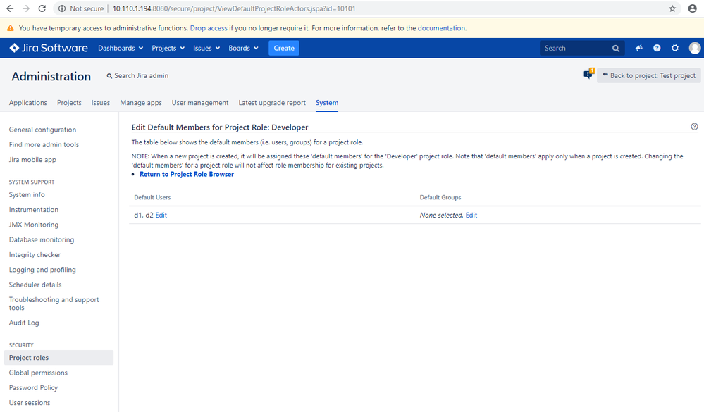

The validator must work in a correct way, please confirm these points:
+ Be careful to include your condition and then publish your workflow too.
+ In addition, have you check your Script Runner is working well?
+ Third thing,  reviewing your roles in your project.

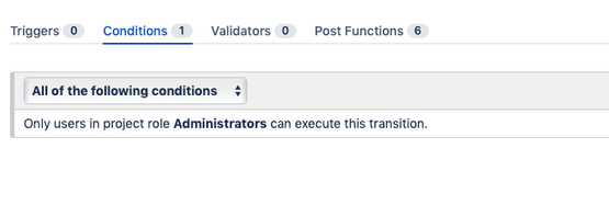

Condition:
Project Roles configuration:

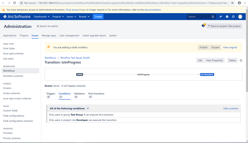

Hi Tauqir, maybe it is a Server condition but I don’t see “user in project role to execute a transition”. I do see “User Is In Any Project Role”. In any event could you share the following:
  • screenshot of the condition details
  • details on what you are seeing when using the first condition..
Tauqir Rao
October 15, 2019
Jack Brickey
October 15, 2019
Thanks. Based upon what I see and assuming d1 and d2 are in the Test group 1 then they should be able to transition to in progress but no one else. Basically both conditions must be met.
so are you seeing all individuals in Test group 1 being able to transition even if they are not in the Developer role?
