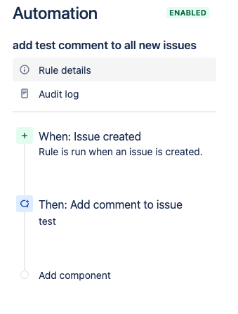

I have automation rules that use the "Issue Created" trigger to check a few things. I realized that automation rule gets trigger without a problem when the issue is created within Jira. But issues created via an Issue Collector that is embedded on an external website do not trigger the "Issue Created" event.
I was able to reproduce it with the simplest of rules: image.png
If the issue is created via an Issue Collector, this rules does not get triggered and does not show up in the audit log. Is this missing trigger a defect or is this the intended behavior?

Quick update: This only happens if the "Report" for the issue Collector is set to "Automation for Jira".
For cases where the reporter is "Automation for Jira", the new issue trigger does not seem to work.
For such cases, a workaround is checking the "Allow rule trigger" checkbox, which will solve the problem (or choosing another value for "Reporter").
I still believe that this is a bug in Jira, but I now have a workaround.
