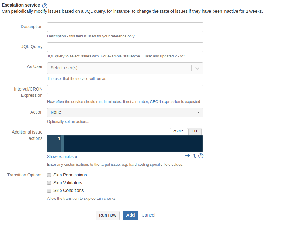

You can write a filter that searches for cloned issues and transition them with escalation service. Escalation service runs according to a cron expression that you define. For example you can check for cloned issues every 10 minute and transition them.
You can use built in features of escalation service (jql query, action) or write a script of your own and run it.
