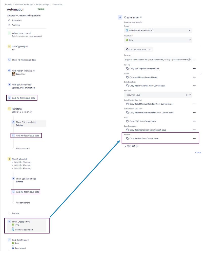

I've updated a rule to copy a paragraph text field from an epic to a story for a create story action.
It has worked and is still working for all other fields in the rule. I re-fetch data at appropriate points, so it shouldn't be a timing issue.
Ideas?

It seems that I needed to add a re-fetch after the completed IF/Else clause, and before the create stories steps rather than after each IF within the if/else clause.
All of the other fields that I copy from the epic are populated when I create the Epic, immediately after which I re-fetch the data so that it can be applied to the stories.
Thanks for the help!

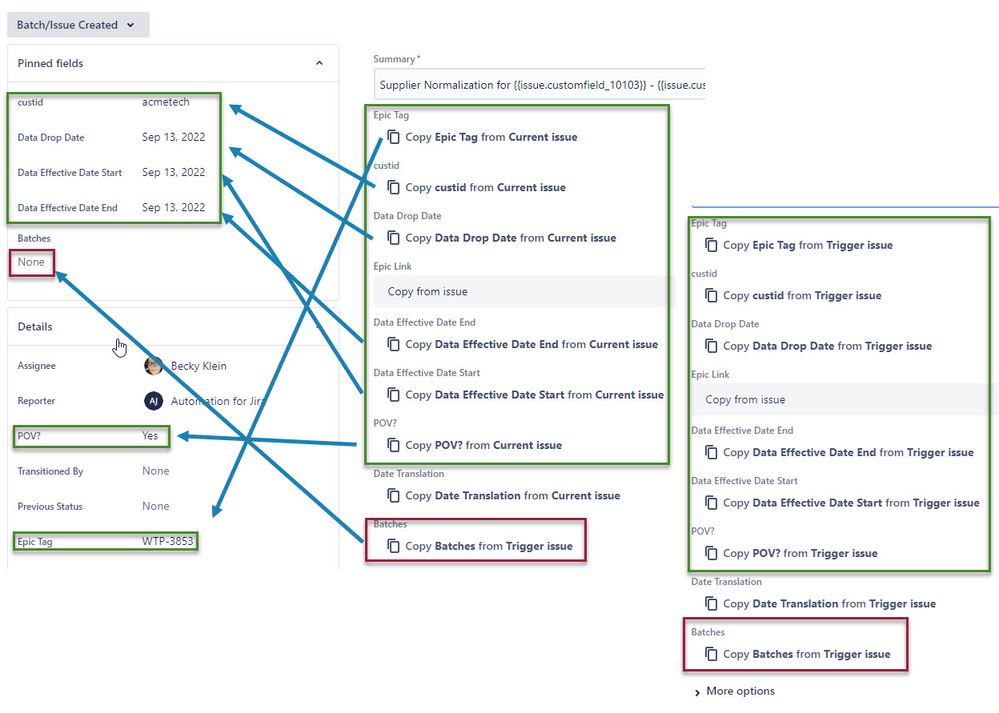

As I mentioned, the rule works for every other Copy from Current Issue action. See attached.
Even so, I did as you suggested, and changed the parameter to Trigger but it didn't change the result. I did two tests..one where I left the Copy from Current Issue as it was on the others, and one where I changed them all to Copy from Trigger. They both worked for all but the Batches field.
I've tried Copy from Current, Epic, Trigger, Parent, and none of them provide the result I'm looking for.
In my experience, Copy from Current Issue has always returned expected results for nested "Create Issue" actions, when I would expect the Trigger, Parent, and Epic to do the same (though they don't always).
It's strange.

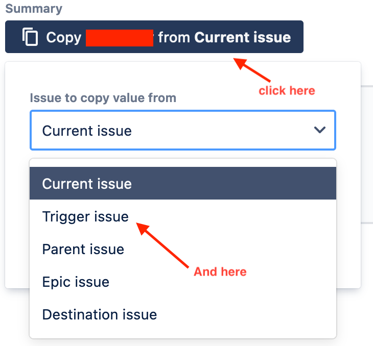

If you would like to copy the batches field from the Epic to the new Story issue, I suggest using the Trigger issue parameter instead of Current issue. The Current issue parameter is copying the value from the Story issue itself, while the Trigger issue parameter will copy the value from the issue that triggered the rule (Epic).
You can do that by clicking on "Copy Batches from current issue" and selecting "Trigger issue":
Let us know if that works.

Hi @Becky Klein - I don't think you need all of those re-fetch actions.  Perhaps one re-fetch just before your create issue action?
Separately, it technically shouldn't matter, but you may want to try changing it from copy from Current issue to Copy from Trigger Issue.
Becky Klein
September 13, 2022
Hi @Mark Segall
The Copy from Current Issue works for this rule.
I needed to remove the re-fetches from within the if/else clause and add one after it.
