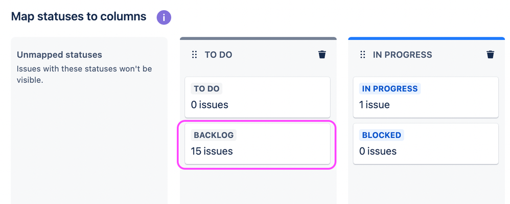

In existing projects, we have both "To Do" and "Backlog" statuses mapped to the 1st column of the active sprint's Board, labeled "To Do". When I create a new issue, it automatically places it into the Backlog, with the status "Backlog". It does not display on the active sprint's Board in the 1st column despite being mapped there (see screenshot). This is how I've always used Jira for probably over a decade.
In our new project with identical Project and Board Settings, when I create a new issue, it automatically places it into the Backlog with status "Backlog" — but it visually displays on the active sprint's Board in the 1st column, together with the "To Do" status issues. "To Do" status (for us) indicates budget is approved & assignee is allowed to start working on the task.

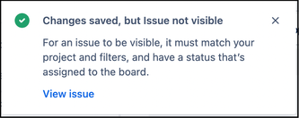

If I un-map the "Backlog" status so that it's not mapped to the 1st column, creating new issues will say (error) that I've successfully created a new issue but that it's not visible (see screenshot).
How can we get the Backlog to operate the way it does in all our other Scrum Board projects? I'd prefer not to add another column for "Backlog", and also don't want to change this Board to Kanban so that we can plan out Sprints (I also don't agree KBs should ever have Backlogs if they're following true Kanban methodology, but that's a discussion for another day...).

For a Scrum board issues will display in the board view only when:
  1. They are assigned a status that is mapped to a column, and
  2. The issue is assigned to an Active Sprint
When you create an issue in a Company Managed project, the issue it will not natively be assigned to any sprint. You could use an Automation Rule to do that or a Post Function in the Workflow Transition to do that.
