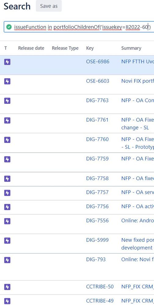

issueFunction in portfolioChildrenOf('issuekey=x-1') =22 results

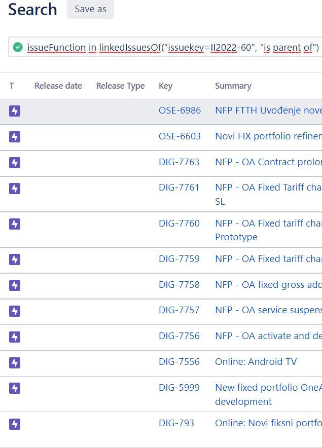

issueFunction in linkedIssuesOf("issuekey=x-1", "is parent of") =12 results

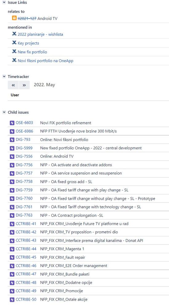

we are using the portfolio Parent link for Initiative-Epic linking. Down the line we use Epic link for Story-Epic linking, but without going further into the hierarchy and complicating, it isn't working at this top level.

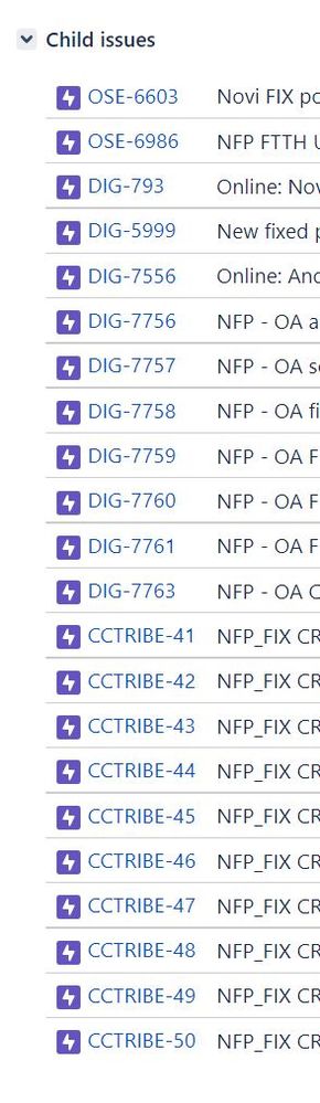

There are 22 issues linked with this same link (see screenshot 1). My understanding is linkedIssuesOf should return all these 22. New screenshot for reference, other issue links here are used for other stuff.

I went digging a little more and this definetly looks like a bug a to me.
In the database, I get 12 issuelinks of type "Parent-Child Link".
So, I took one of the issues that are missing CCTRIBE-41, deleted what was in the parent link field, then I filled the Parent link field again with the same thing. Voila, there are now 13 results instead of 12. Still can't figure out where are the other links stored and how are they shown on Issue details...
