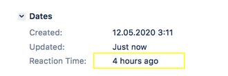

I create rule. when priority of a sub-task created or updated change reaction time.{{now.plusHours(8).jiraDateTime}}
but when I change priority in the issue it shows me Screen Shot 2020-05-21 at 11.20.49.png
How is it possible?

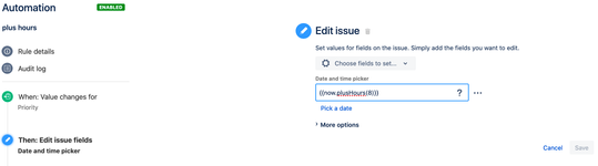

Per your description, it seems you are looking for a way to add 8 hours ahead from the current time to a custom field when the priority is changed. Is that correct?
If that's what you are trying to achieve, I believe the following rule should work for you:
Let us know if you are trying to achieve a different goal.

Hello @Petter Gonçalves
you wrote the same code like I made but still it went me wrong answer "4 hours ago"
Look at the screen, please.

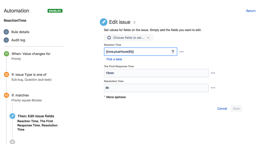

Can you please send a print of your rule?
Also, you mentioned that you added the parameter {{now.plusHours(8).jiraDateTime}} instead of {{now.plusHours(8)}} as I did. Can you please change the parameter and check if it worked?
Additionally, I tested the rule out of business hours and it has properly worked.
Виктория
May 26, 2020
@Petter Gonçalves
its working also like your {{now.plusHours(8)}}.
jiraDateTime - just type of field
Screen Shot 2020-05-26 at 15.25.30.pngin the end same -same problem
