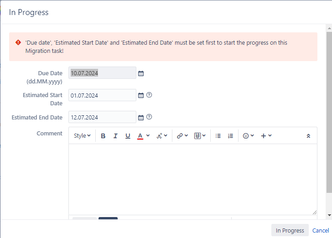

Ashima Bhatia
July 8, 2024
Hi Anna,
Sharing the SIL script, which is added as a validator for In Progress transition of my workflow.
string errorMsg = "'Due date', 'Estimated Start Date' and 'Estimated End Date' must be set first to start the progress on this Migration task!";
if ((project == "DACL" || project == "ADDEMERGE") && type == "Migration") {
if ( !hasInput("dueDate") || !hasInput(customfield_13606) || !hasInput(customfield_13607)) {
return false, errorMsg;
else
return true;
Thanks
