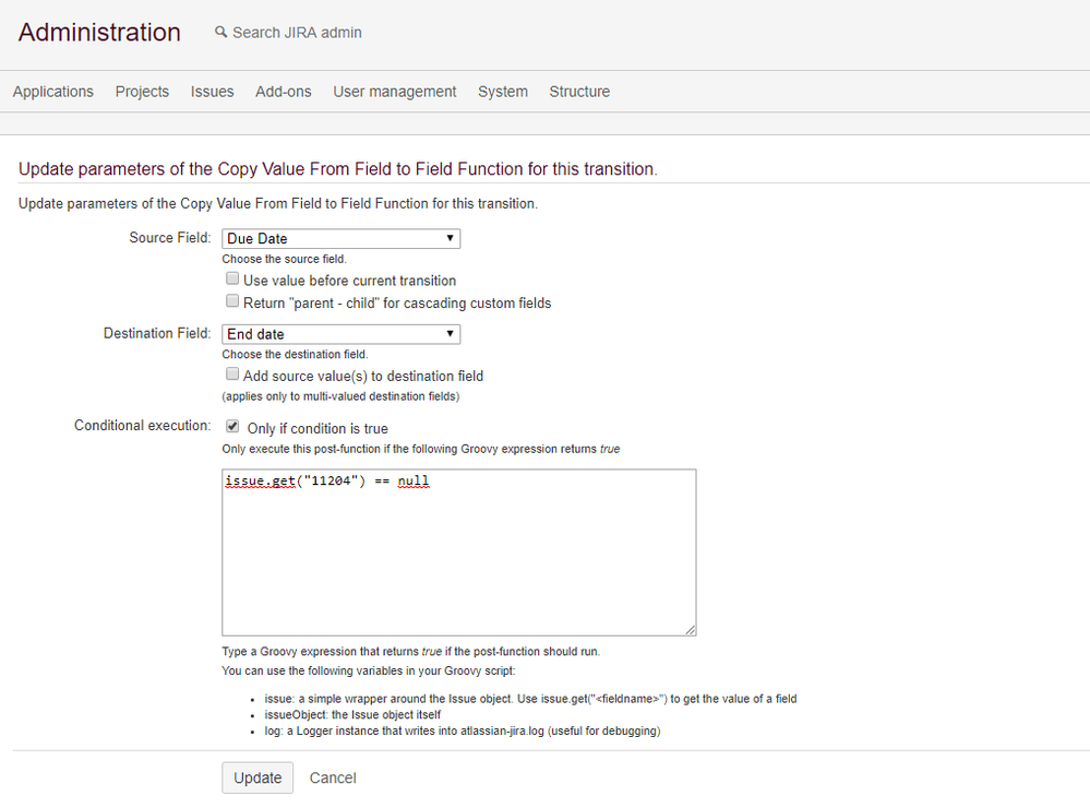

I was trying to make a postfunction that copies the due date to the end date
but only when the end date field is empty
because they may be different, when they are different they should not copy.
all of these are custom fields
help!!

You seem to be using a very old version of JMWE. In more recent versions, you would have a simple checkbox to check: "Copy only if not set"
If you don't want to update JMWE, you can use the following conditional code:
issue.get("customfield_12345") == null
where customfield_12345 is the field ID of your End Date custom field (see https://confluence.atlassian.com/jirakb/how-to-find-id-for-custom-field-s-744522503.html

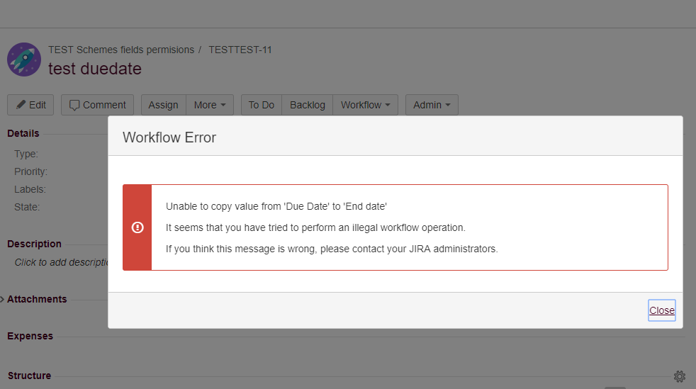

yes i am using an old version, with jira 7.0.4 we arent upgrading in the short term, so i used the lined but still giving me error
see attachment:

I believe this latest error has nothing to do with the conditional execution script. It's easy to check: just uncheck "only if condition is true".
If you look inside the Jira logfile (atlassian-jira.log), you'll find the full error, accompanied by a stack trace. Can you post them here? My guess is that the two fields are incompatible. What is the type of the End date field?
This would not happen with JMWE 5.x, which handles conversion between incompatible field types (among many other new features). Note that JMWE 5 is fully compatible with Jira 7.0.4...

the post function with out any condition works perfectly
on the other hand:
"End date" is a "date picker" field, while "Due date" is a "date" field

Ok, I found the issue. The conditional execution script should be:
issue.get("customfield_11204") == null
You had forgotten the "customfield_"
marçal martorell
March 7, 2018
it's working
haha! thank you, that was desperating
thanks again!

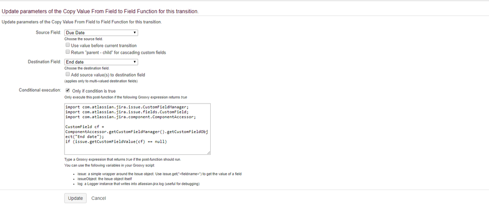

As per the docs you have to *return true or false* for the condition to proceed or fail.
The post-function is executed only if the written condition evaluates to true or a Groovy truthyYou can quickly test your written script against any issue using the script tester tool.
https://innovalog.atlassian.net/wiki/spaces/JMWE/pages/73302064/Conditional+execution+using+Groovy+expression
Tarun Sapra
March 6, 2018
if(issue.getCustomFieldValue(end date)) {
return false;
} else {
return true;
This should do the trick.

this is it:
import com.atlassian.jira.issue.CustomFieldManager;
import com.atlassian.jira.issue.fields.CustomField;
import com.atlassian.jira.component.ComponentAccessor;
CustomField cf = ComponentAccessor.getCustomFieldManager().getCustomFieldObject("End date");
if (issue.getCustomFieldValue(cf) == null)
Tarun Sapra
March 7, 2018
if (issue.getCustomFieldValue(cf) == null) {
return true;
} else {
return false;
Add the above snippet in your code.
