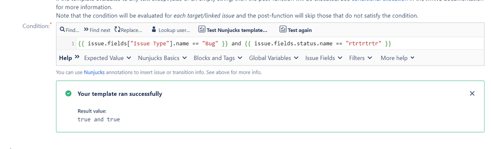

i am trying to add assignee when condition is status "trtrtrtr". the test passes well but assignee not working.... what i am doing wrong?

Hi @valkyre57 ,
Note that all the clauses must be inside a single {{ }} block :
And, of course, the user executing the post-function must have assign issues permission.
Thanks,
Suprija

i tried single block too. user has permissions.

Hi @valkyre57 ,
Did you test without the Conditional Executional script? - i.e., is the Assignee being set correctly without the conditional execution script?
As you are checking for the status of the issue - note that the issue's status will be either the Status before the transition or the Status after the transition - as post-functions in cloud run asynchronously
If you want to check the destination status : use transition.to_status
{{ issue.fields.issuetype.name == "Bug" and transition.to_status == "rtrtrtrtr" }}
Else, if you want to check the source status : use transition.from_status
{{ issue.fields.issuetype.name == "Bug" and transition.from_status == "rtrtrtrtr" }}
Thanks,
Suprija

transition.to_status WORKED
thanks a loooot !
