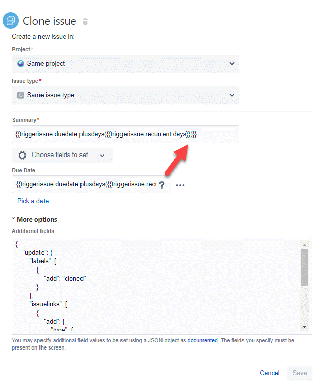

So if I use the function below and hardcode a number, it works. But if I pass in a variable, it does not work.
Does plusdays not accept variables? If it does, what am I doing wrong?
{{triggerissue.duedate.plusdays({{triggerissue.recurrent days}})}}

October 7, 2020
Hi,
PlusDays function expects a number value I suppose.
What is the output of {{triggerissue.recurrent days}} ? If that gets a number value, try
{{triggerissue.duedate.plusDays({{triggerissue.recurrent days}})}} or
{{triggerissue.duedate.plusDays({{issue.customfieldId}})}} where customfieldId is the field id of triggerissue.recurrent days
JJ
October 7, 2020
The outcome of triggerissue.recurrent days is a double. So that's definitely working.
