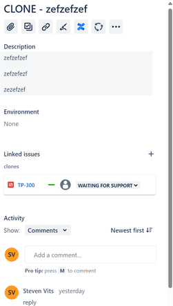

When you clone an issue, do you see an entry added to the Issue Links section for both the original and new issue? Can you provide a screen image of the issue where you would be entering the comment that triggers the rule? In that image I'd like to see the Issues Links section. Please then indicate which issue in that section you consider the "parent".

Steven Vits
January 29, 2024
Thank You for the clear understanding, it seems indeed I was missing some correct defining of the terminology.
Wat I am trying to do is copy comments when the master clone is in 1 specific project.
The left Issue is the 'master' and the right one is the 'slave'.
When master or slave I do want the comments be copied in each other only when master is in project TP.

In this Case I shall have to look after the 'Is cloned by' by and 'clones' in at least one 'related issue condition'.
I will search further on that. maybe it will be necessary to provide 2 rules, 1 for cloned by relation and one for clones relation.

I would indeed recommend that you create two rules; (1) one for copying comments from the source issue to the clones, and (2) another for copying comments from the clones to the source issue.
Rule 1: copy from source issue to clones
TRIGGER: comment added
CONDITION:
if the rule should be limited to issues of a specific type,
add a condition to check the issue type
CONDITION: Issue Fields
Field: Project
condition: equals
value: TP
FOR EACH: Related Issue
Type of Related Issues: Linked Issues
Link Types: is cloned by
ACTION: Comment on Issue
Here you can reference pieces of the comment that triggered this
rule using {{comment}} such as {{comment.body}}
Rule 2: copy from clones to source issue
CONDITION:
Field: Project
condition: is one of
value: (select all the projects where clones may exist for TP issues)
Link Types: clones
CONDITION: Issue Fields (checking if the source issue is in TP)
Field: Project
condition: equals
value: TP
