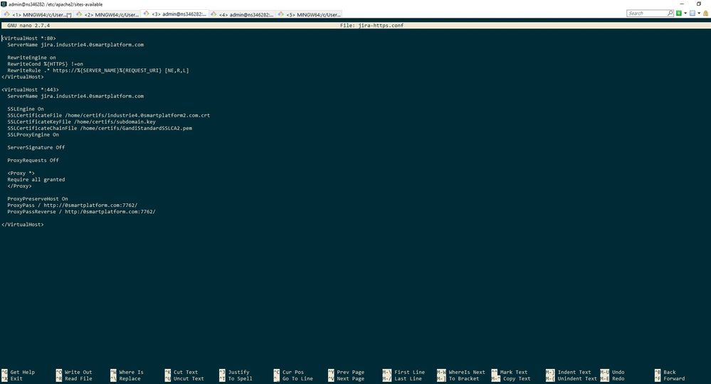

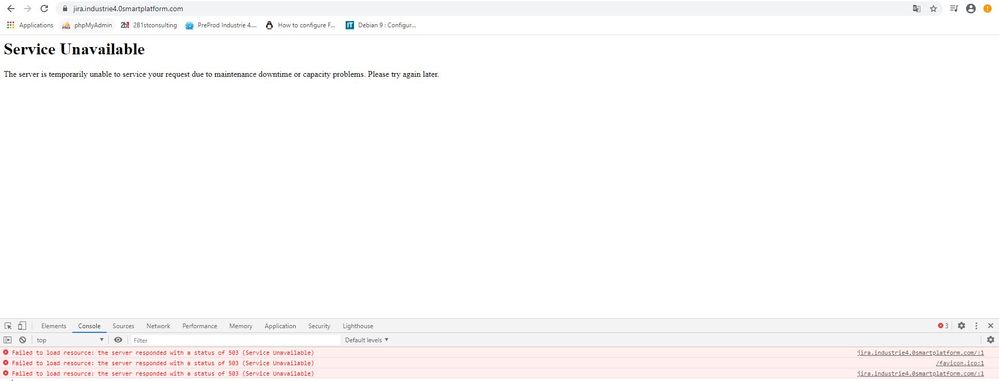

you will find in attachment the Virtual Host on Debian Serve with Apache Web server and the screenshot of the browser error.

Not an Apache expert but your configuration seems right, that being said the ProxyPassReverse parameter is missing a "/" after the protocol part (http://s01......). Let us know if it makes it!
Cheers

Hi Miikhy,
Thanks for reply,
indeed it was missing a slash but it didn't change anything and the problem persists.

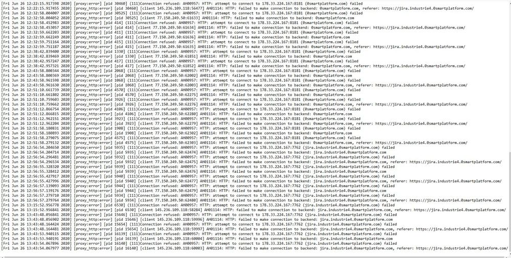

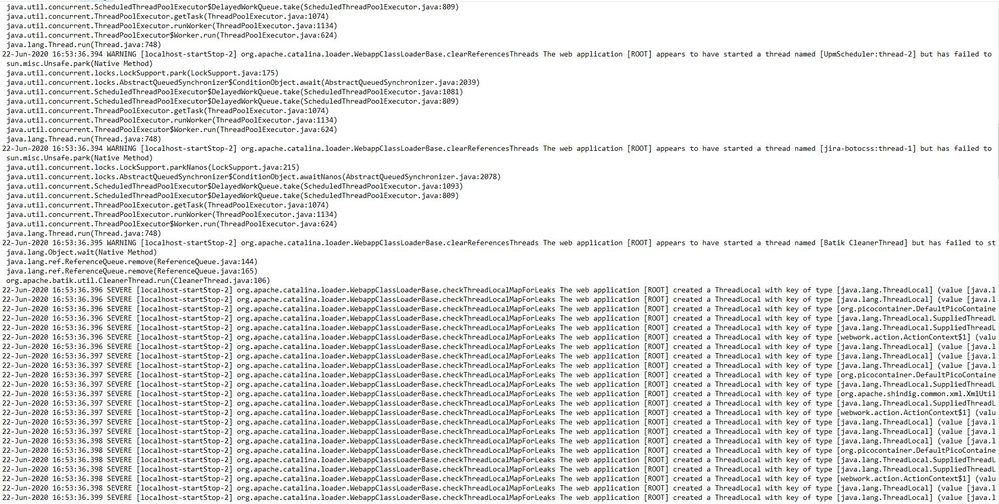

Attached are logs from /opt/atlassian/jira/logs/ and Apache logs :

June 29, 2020
Hi Miikhy,
After completely re-installing the Jira application
everything's back to normal
Thanks,
