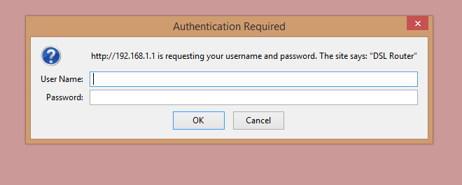

hiba zubair
August 19, 2017
ok have tried and it says for authentication as the screen shot below it is accepting the IP DNS Server url and once i enter the username and password of the router the screen is refreshed with empty fields again.not moving forward.....would appreciate if u give idea.
Nic Brough -Adaptavist-
August 20, 2017
That tells me that either you've put in the address of the router instead of the JIRA server, or your network is configured to block access.
Again,
  •     Look at the base-url of the service (note that it should not be "localhost" - use the name of your server or its ip address)
  •     Put it into the address bar in your browser.
  •     You now have a login screen.
  •     If you have not set up any names/dns or routing, then your base url will probably need to be http://192.168.1.24:8080 (replace the 192...24 with the IP address of the server)
 If you do not get a login screen, then your network is not configured to allow the connection.  You will need to fix that yourself, we can't know how your network is set up.
