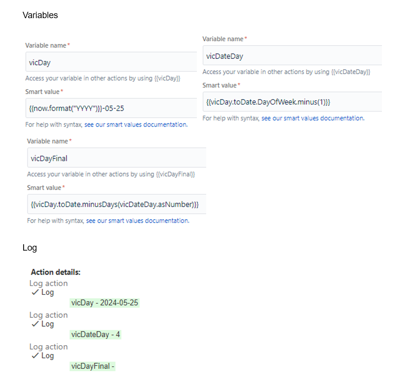

I have checked many posts here and seems to write my smart value correct however, output is blank.
My first variable: {{vicDay}} is defined as
{{now.format("YYYY")}}-05-25
My second variable: {{vicDateDay}} is defined as
{{vicDay.toDate.DayOfWeek.minus(1)}}
Both variables return values in the log: as 2024-05-25 and 4 respectively
Now, I use the numeric value in my third variable: {{vicDayFinal}} defined as
{{vicDay.toDate.minusDays(vicDateDay)}}.
When I type in numeric value in the formula {{vicDay.toDate.minusDays(4)}} it returns 2024-05-20 as expected, when I use vicDateDay variable name then it returns null. The log shows that vicDateDay is Numeric.
Here is the log:
vicDay - 2024-05-25, vicDateDay - 4, vicDayFinal - , isNumeric - true, isAlpha - false
Anybody please help me on this.
Thanking in advance.

Created Variables are text.  When you want to use them in a function such as minusDays() they must be converted with asNumber:
{{vicDay.toDate.minusDays(vicDateDay.asNumber)}}

Hi Bill, I calculate Victoria Date as a variable. I tried asNumber function and the output is still null. Log is below
Log action
Log
vicDay - 2024-05-25
Log action
Log
vicDateDay - 4
Log action
Log
vicDay.toDate.minusDays(vicDateDay.asNumber)-
I need to exclude my scheduled trigger run on holidays, this is the objective of exercise.

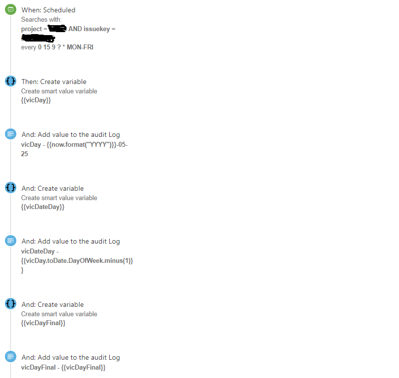

Please post an image of your complete rule (in one image) and an image of the audit log details showing the rule execution.  Those will provide context to help explain what you are observing.  Thanks!
Anna
May 14, 2024
Bill, please find attached rule with detailstrigger flow.pngvariables and log.png

Where you write the smart value expressions to the audit log, try writing the variables instead: {{vicDay}}, {{vicDateDay}}, and {{vicDayFinal}}
That will help confirm the variables contain what you expect.
Also, smart values are case-sensitive, and I believe the attribute DayOfWeek should be dayOfWeek: https://confluence.atlassian.com/automation/jira-smart-values-date-and-time-993924864.html#Jirasmartvaluesdateandtime-attributesAttributes

hi Bill, thanks a lot for your reply. I have fixed the case to dayOfWeek and always check each calculation in log when move to the next step. I added variable where argument is explicitly defined as number and it works:
{{vicDay.toDate.minusDays(vicDateDay.asNumber)}} - returns null
{{vicDay.toDate.minusDays(4)}} - returns 2024-05-20 as expected
so the issue is caused by variable argument.
