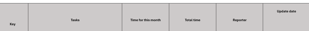

Diallo
February 2, 2026
Thans for your feedback, i tried your advice but it's still happening =>
<table border="0" cellspacing="0" cellpadding="6" style="border-collapse:collapse; width:100%; table-layout:fixed;">
<thead>
<tr style="background-color:#CDCACA;">
<th style="text-align:center; width:10%; border:1px solid #000; padding:6px; font-weight:bold;">Key</th>
<th style="text-align:center; width:30%; border:1px solid #000; padding:6px; font-weight:bold;">Tasks</th>
<th style="text-align:center; width:15%; border:1px solid #000; padding:6px; font-weight:bold;">Time for this month</th>
<th style="text-align:center; width:15%; border:1px solid #000; padding:6px; font-weight:bold;">Total time</th>
<th style="text-align:center; width:15%; border:1px solid #000; padding:6px; font-weight:bold;">Reporter</th>
<th style="text-align:center; width:15%; border:1px solid #000; padding:6px; font-weight:bold;">Update date</th>
</tr>
</thead>
<tbody>
{{#lookupIssues}}
<tr>
<td style="padding:6px; border:1px solid #000; text-align:center;"><a href="{{toUrl}}" style="color:#0052CC; text-decoration:none;">{{key}}</a></td>
<td style="padding:6px; border:1px solid #000; text-align:center;">{{summary}}</td>
<td style="padding:6px; border:1px solid #000; text-align:center;">{{#=}}(0{{#worklogs}}{{#if(started.isAfter(now.withDayOfMonth(1).toStartOfDay))}}+{{timeSpentSeconds}}{{/}}{{/}})/3600{{/}}</td>
<td style="padding:6px; border:1px solid #000; text-align:center;">{{#=}}(0{{timespent}})/3600{{/}}</td>
<td style="padding:6px; border:1px solid #000; text-align:center;">{{reporter.displayName}}</td>
<td style="padding:6px; border:1px solid #000; text-align:center;">{{updated.withLocale("fr").asMediumDateTime}}</td>
</tr>
</tbody>
</table>
The problem is the first and the last column, the title of the first one goes down and the last one goes up higher (its content) I don't know why even though they have the same padding dimensions
