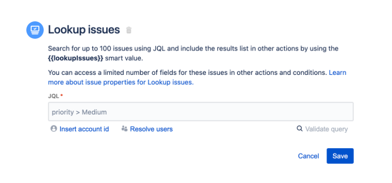

In your automation are yo actually filling the list of the lookup? Just calling the lookup smart value doesn't contain anything. You will need to fill it first with a Lookup Action.
You have to add this action before you use the smart value (with a proper JQL), otherwise it will just be an emtpy smartvalue.
https://support.atlassian.com/jira-software-cloud/docs/automation-actions/#Automationactions-Lookupissues

Thank you! That was the missing piece from the example I read.
