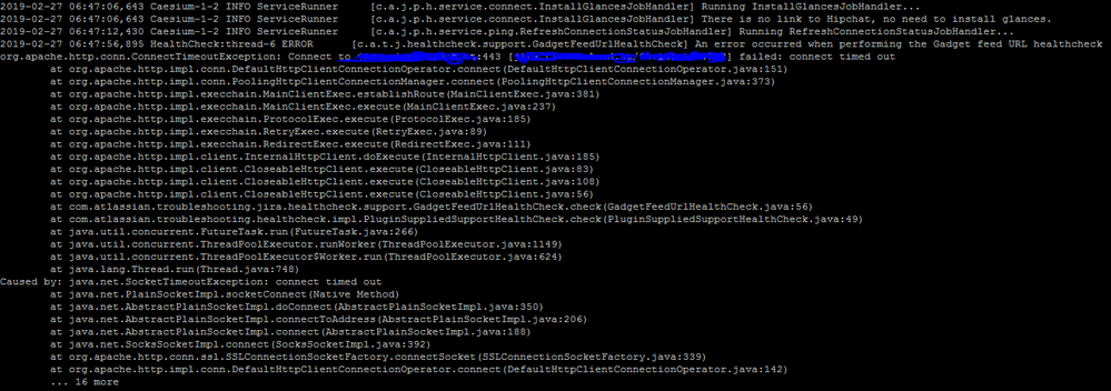

Jira itselfs only showing me this failure in troubleshooting and supporttools:
Log files:
(Catalina.out)
(atlassian-jira.log)

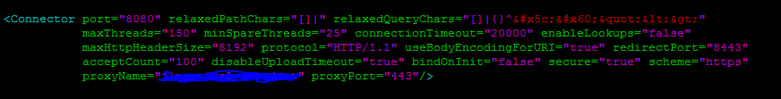

And this is our server.xml configuration:

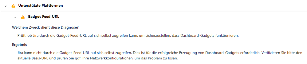

That sounds like a very long time to wait just to login.   I don't see any clear configuration problems with the screenshots you have supplied.  Perhaps there is a problem with the Jira Application being unable to reach it's base URL https://jira.example.com for example.
There is an expectation that the application itself can reach it's logical network address.  And not all past versions of Jira required this explicitly (Jira 7.0.x and before could work well without this, but starting in 7.1, Jira changed the way this works).  This requirement could be why you are getting that gadget/healthcheck error.  But I'm not convinced this is the same cause of the long login times.   It might help to review the KB How to fix gadget titles showing as __MSG_gadget to address that problem.

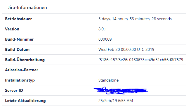

Jira Information:

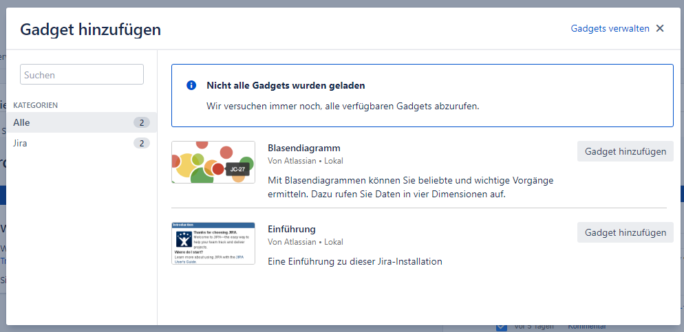

I've deleted the Projects Gadget (where I can see which project is asigned to my account) from the system dashboard and now it looks like the login problem has gone but now its clearly, that the problem has something to do with the gadgets because I cannot activate any.
Do you know how I can troubleshoot this?
