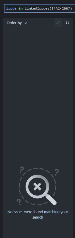

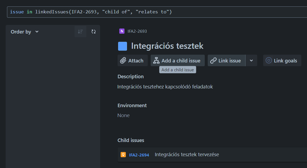

it seems like the query doesn't works. the result column is empty, the existing issue is from a previous search.
what do I miss?

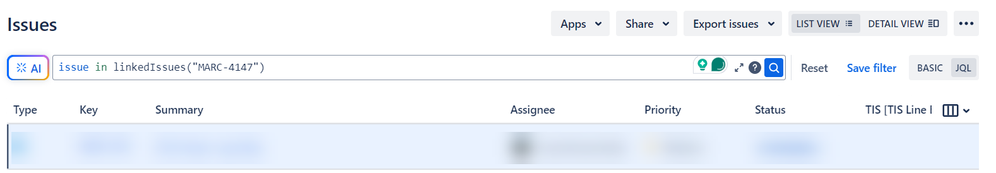

Hi @Tamás Szalisznyi ,
issuein linkedIssues("MARC-4147") - example of a query that worked for me.
This JQL showing you how to search by link, not by parent/child relationship.

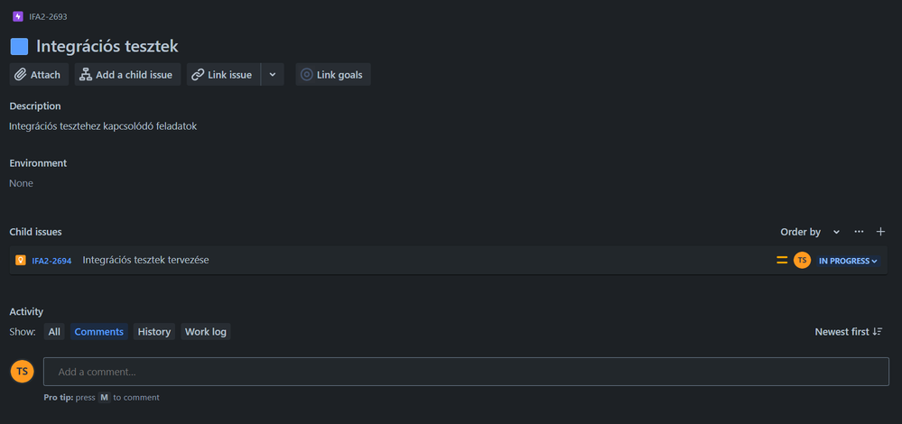

@Tamás Szalisznyi can you share a screenshot of the issue links of issue IFA2-2693?

sorry for the late answer, for a short time I thought i leave it, somebody will fix it, but today here is another query: (screenshot made at may 28)
and more screenshot from previous:

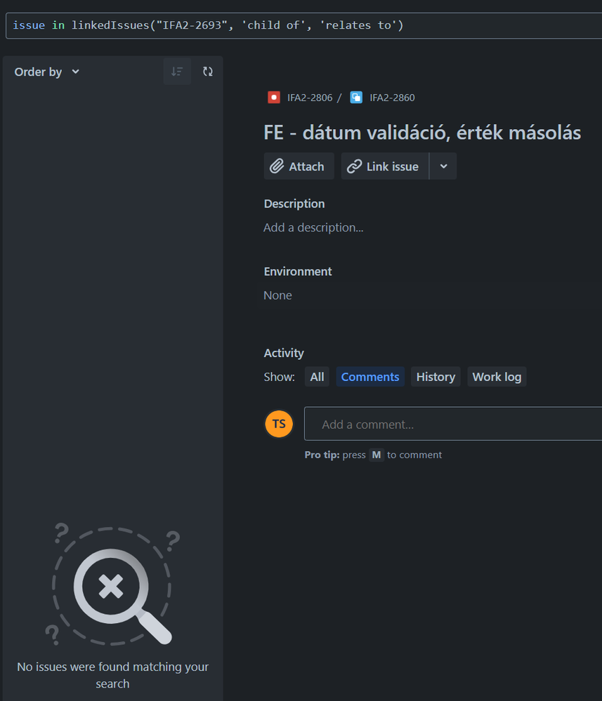

another try, same result:
your suggestion has a syntax failure:

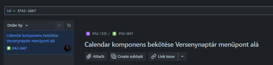

for your question too:
i changed the id for a simple story, with epic parent and sub-task child, same result.
