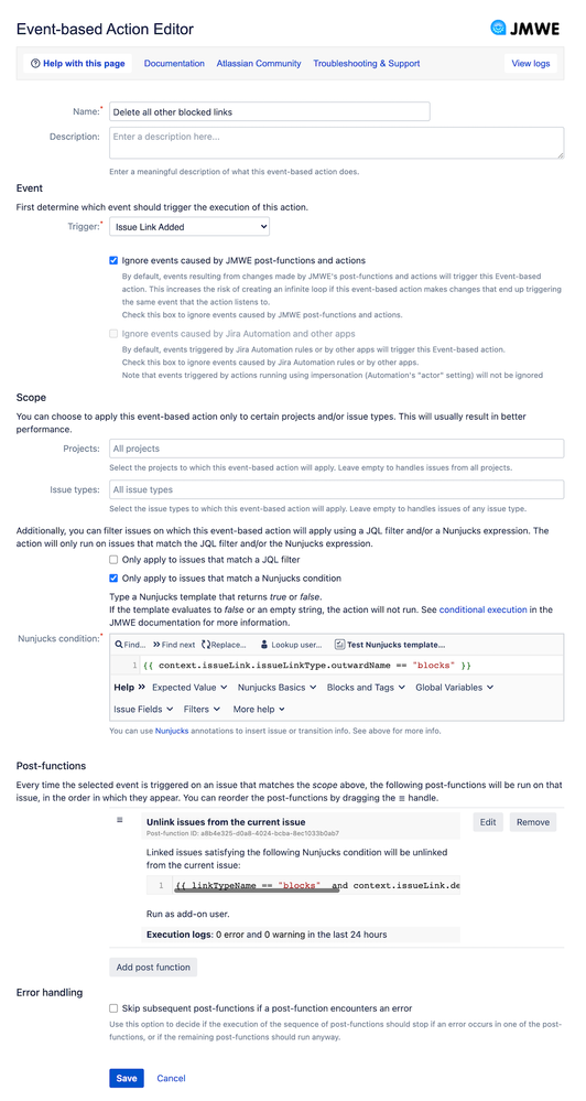

where are you placing this JMWE post-function? On a transition, or on an Event-based action listening to the issue_link_created event?
If on the latter, then this is the configuration you want:
The Nunjucks condition for the Event-based action is:
{{ context.issueLink.issueLinkType.outwardName == "blocks" }}
The Nunjucks condition for the Unlink Issues post-function inside the action is:
{{ linkTypeName == "blocks" and context.issueLink.destinationIssueId != linkedIssue.id }}
Of course, you'll need to adjust both for your issue link type direction. Replace "blocks" with "It is from the Program" and, if "It is from the Program" is not the "outward" link type direction name (on the Issue Linking admin page), then replace inwardName with outwardName in the first script.
