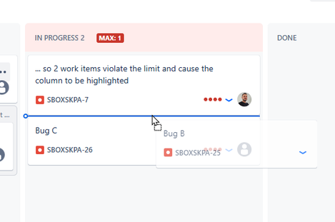

When you're dragging an issue to a different column, you should be able to chose the position of it by using these horizontal lines.

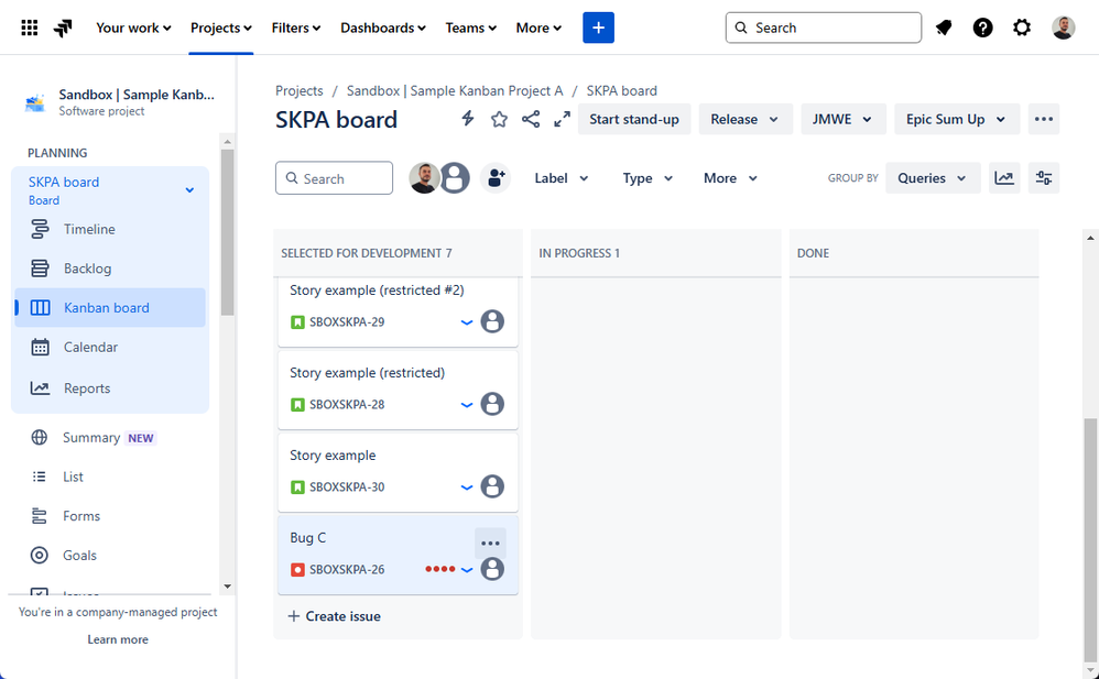

👉 However, if you got many tasks in a column and you would like to move it quickly from top to bottom for example (or vice versa) by using these shortcuts:
  • s + - move selected card to top
  • - move selected card to bottom
Note, card needs to be selected/highlighted blue to use these shortcuts.
You can find more info about the shortcuts here.
