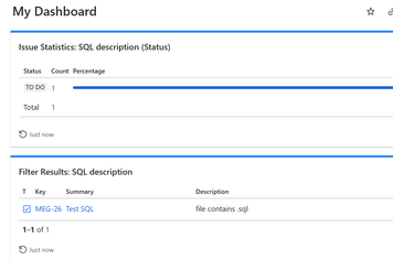

Hi @Livio Patavini ,
"the related dashboard using it, seems not return the jira issues including the ".sql""
-- Can you tell us what gadget is being used in the dashboard. Some screenshots will help us identify it properly.
Also please check if the filter saved in shared with correct users.
I created a sample jira work item with .sql text in description field and the gadgets in the dashboard are showing the results.
Please note: If you have attached the .sql file in the description field and trying to search, then this will not work.
