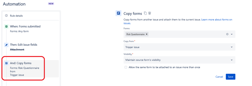

@Jehan Bhathena unfortunately it did not work, I got empty value instead, so there I raised this topic.

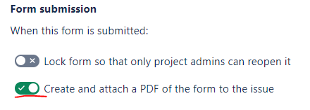

@Sam Harding I found easier solution. Just in form settings I checked on this functionality and for each form in the issue pdf is created automatically.
Kind Regards, Paweł

Jehan Bhathena
June 24, 2023
Hello,
Does the "Copy Form" action in Jira Automation work for your use case by any chance?
