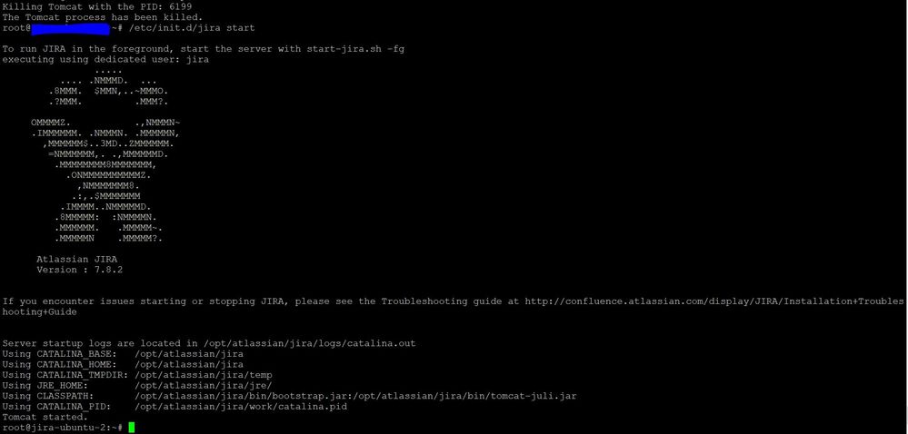

I have followed this article only. I manually changed server.xml as given on that article and restarted jira service but it is still not taking port 80 into effect. May be its because of ubuntu, as given on the same article, that in ubuntu in order to bind port 80 you need to restart the service as root. so now question is how can I start my jira service as root? currently I start and stop my jira service using below commands
/etc/init.d/jira start
/etc/init.d/jira stop
is it ok to start and stop jira like that?

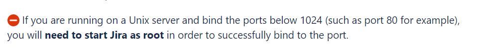

Below is screenshot of that line, in that article, which says running jira as root user

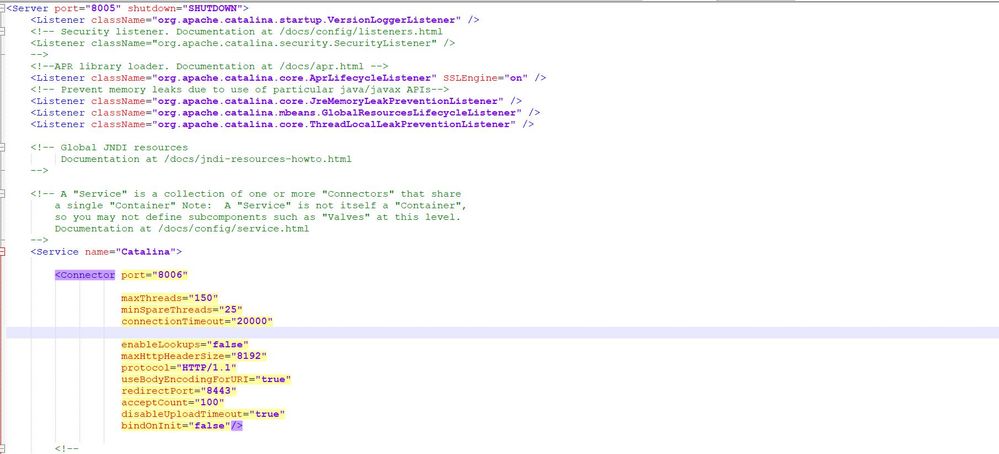

mdesai
May 8, 2020

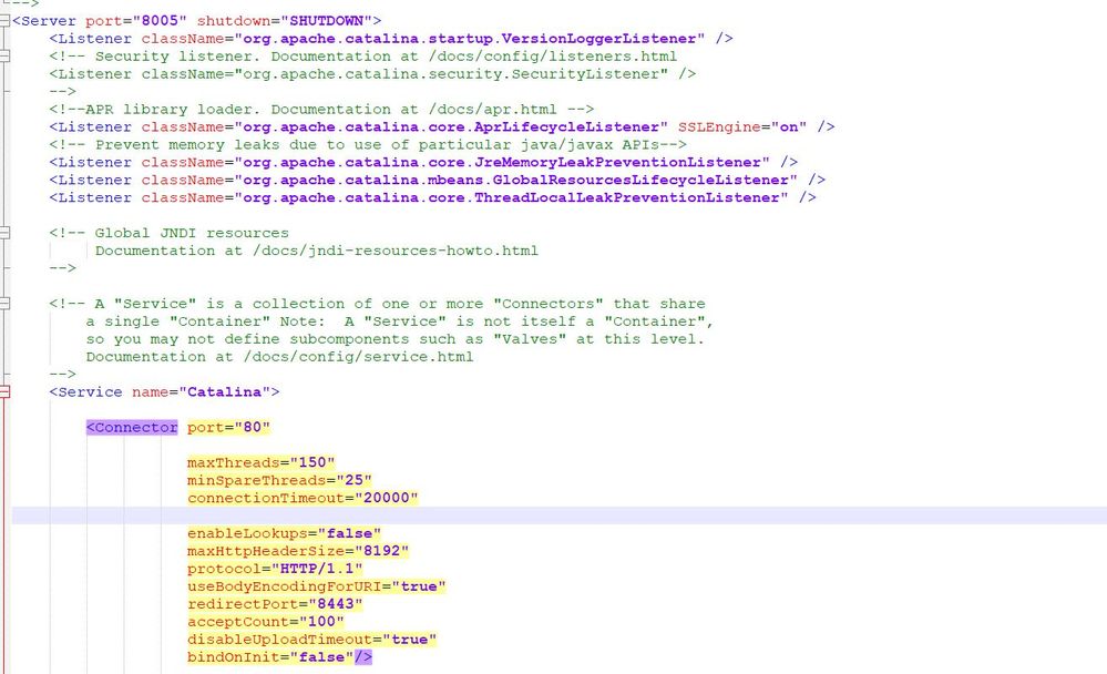

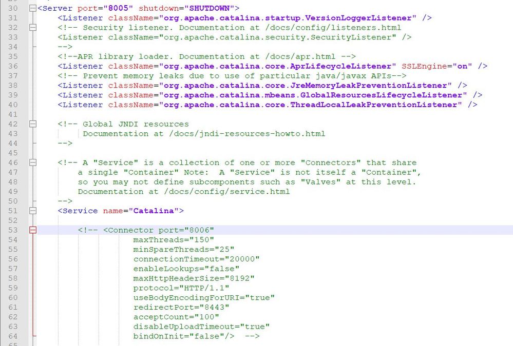

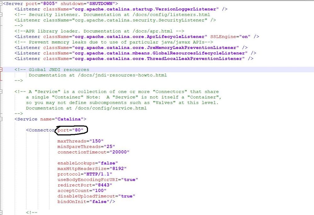

Attaching here with server.xml file screenshot after changing port from 8080 to 80

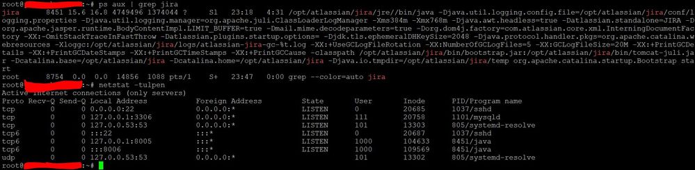

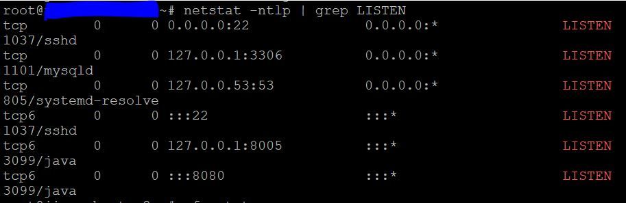

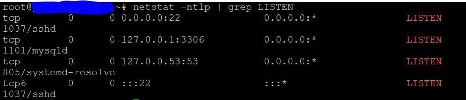

Also attaching  result of running below command through putty
netstat -ntlp | grep LISTEN
(before changing port in server.xml)
(After changing port in server.xml from 8080 to 80)

@mdesaiThe question is did you change port  in the server.xml  you said you change it earlier. If the port is below 1024, then you will  need to start jira with  root user why? because port < 1024 are already used and grouped  over the internet and the root user will enforce the bind port 80  even though it is  widely used over the internet. But since you have change the port and remember, check all port by using the netstat -tulpen, to see all port in use, and choose port greater that 1024 so that you will not need to start jira  with  the user root.  Further more, you should check port,  by typing below on Ubuntu terminal  below commands to check  whether java is running on this port you have  changed. To  identify the java process id,  first  type
ps  aux | grep jira    " to  get the process id aka PID followed by the below "
netstat - tulpen     "to see the TCP port java process is running on
Let me explain, starting jira as a service means that you have a dedicated user to  start jira (Just best  practice)  if you start jira  as root then you will  over write  all  files permission to  root, and you can no longer start  jira as  a service because the user jira will  not have the permission to  start  jira. You will have to  do
chown -R jira:jira  file_name  " i.e to  all files in jira_home and installation folder to  be able to run as a service".
I  Hope it is clear now, please give feed back .

here is what I am doing now step by step,
Step-1

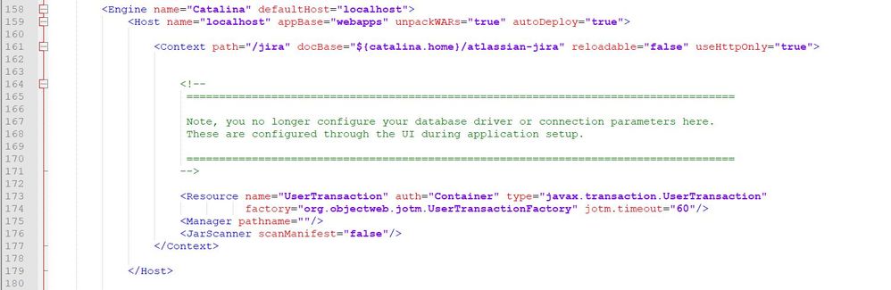

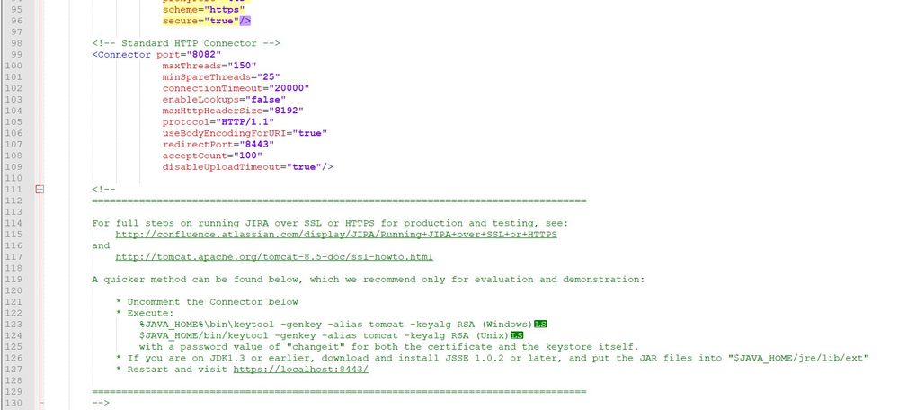

I changed my server.xml file in /opt/atlassian/jira/conf directory and manually changed <Connector > port from 8080 to 80 and here is the resulting server.xml file
 Step 2

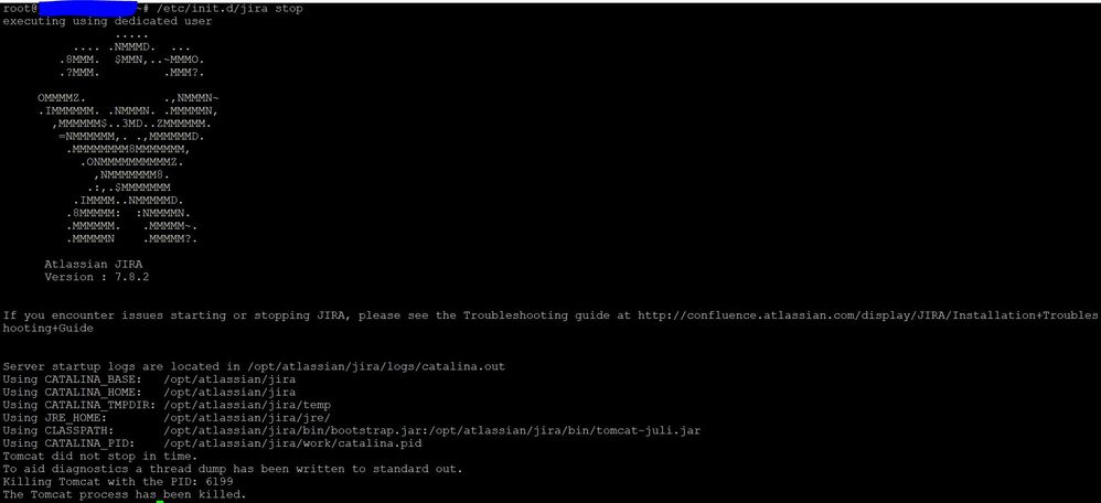

After that to restart jira service I ran below command to stop jira service
Step 3
Then to start jira back again I ran below command

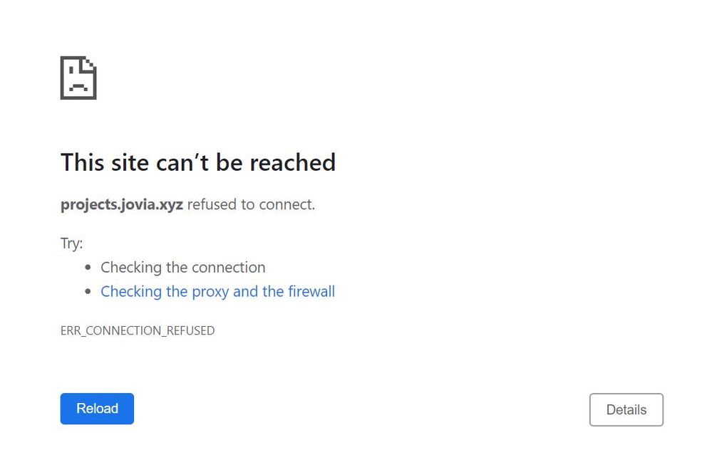

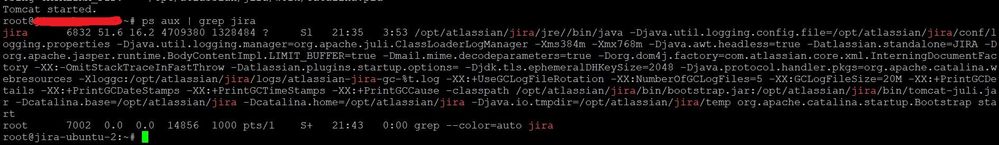

after that I am checking the url in browser but it displays below error
Step 4

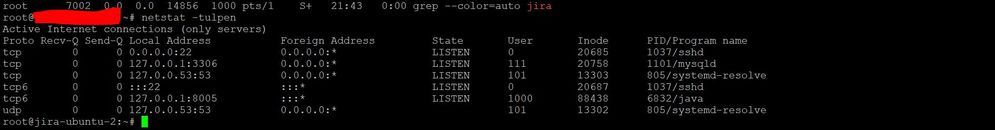

As explained by you, I am running below commands after this to check which port java process is using
ps aux | grep jira
Step 5
I ran below command right after that
Based on this can you tell me where am I doing wrong?  In last screenshot, why java service is running on port 8005?

mdesai
Moses Thomas
May 8, 2020
@mdesai  As i have mentioned, please change port 80 to  a port not mentioned when you type  netstat -tulp   for  instance 8006.  That  java  process running at port 8005   is  for the whole Jira server,  now  the port 80   is for Tomcat  server connector  which is  embedded in JIRA, for  JIRA  to  run. And to make port 80 work you need to  run as root to force bind port 80.
So please change port  80 to 8006 and we will  be happy  as  long there is no fire wall blocking  TCP connect at 8006 :)

@Moses Thomas  Excellent explanation. I changed port from 80 to 8006 and it started working. Here is my server.xml file now.
Here is netstat -tulpen result

Also, all these commands I am running by logging into putty using "root" user only. When you say "you need to  run as root to force bind port 80." what exactly do I need to do?
Can you give me command to run as root to force bind port 80? And I should only do that if I am changing my <connector> port from 8006 to 80. Correct?

mdesai
May 8, 2020
@Moses Thomas Thanks for clarification. That was really helpful.
I changed my port number from 80 to 8006 in <connector> tag in server.xml file and it is working fine now. Here is my server.xml file.

Also, All these commands I am running by logging into putty using "root" user only.
so when you say "to make port 80 work you need to run as root to force bind port 80", what command should I run exactly for achieving that? And I should be only doing that if I change my <connector> port to 80 , correct?

OK now that JIRA is working great forget about running JIRA as root  to  enforce port 80 because you will just  get what we have achieved,  but the right way  to set up JIRA  been accessible through  http://[myhostname].com/jira on standard HTTP port 80 while JIRA itself listens on port 8006 with context path /jira. (to add context path see here Change the context path used to access Jira server )
You have to  run JIRA via  a reverse proxy  either by using apache or  Nginx,  and i choose  Nginx   because it has several advantages and easier to configure for me.

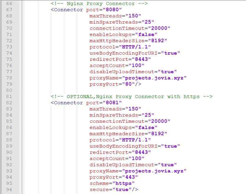

mdesai
May 11, 2020

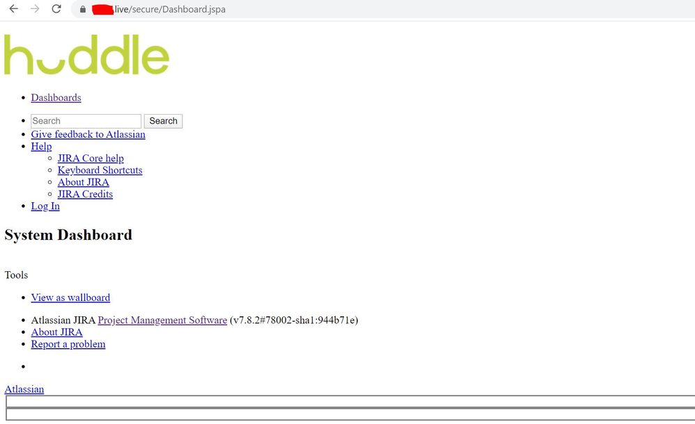

Hi, @Moses Thomas  thank you so much for your help. Excellent explanation!
I followed all setps as mentioned and everything is working fine now using below url
http://[myhostname].xyz/jira/secure/Dashboard.jspa

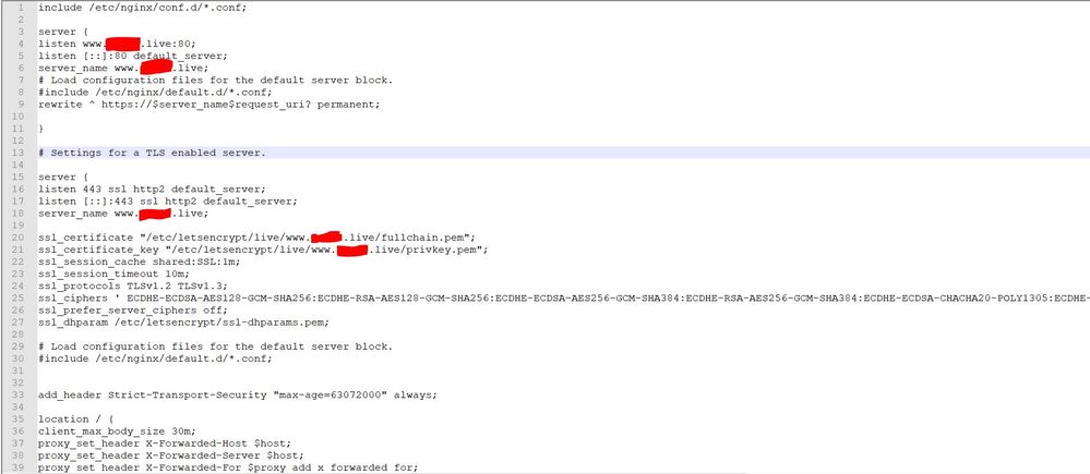

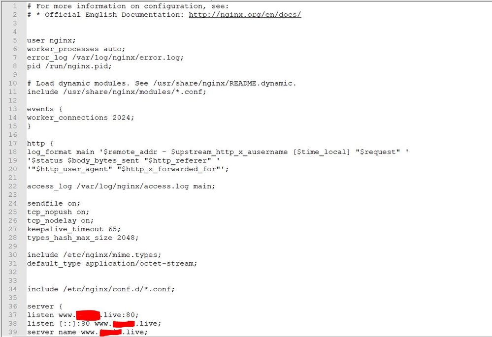

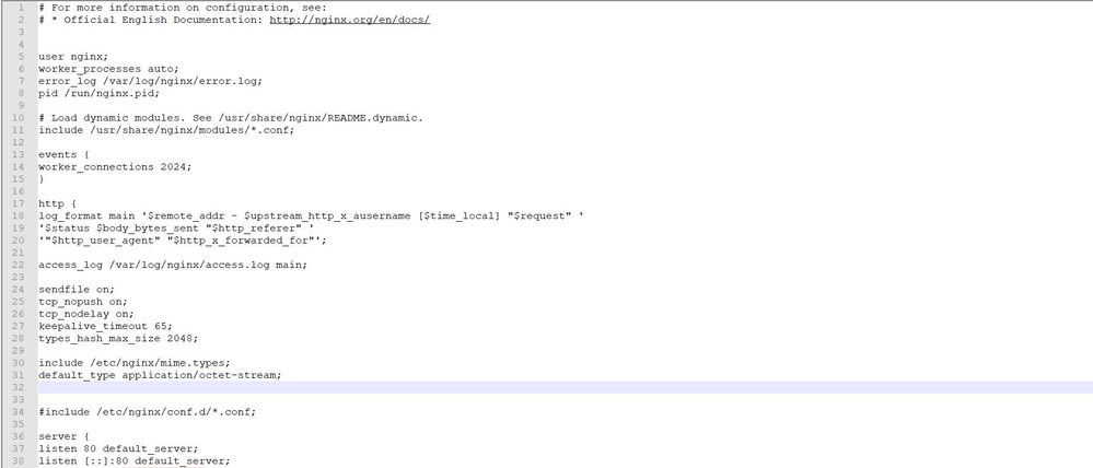

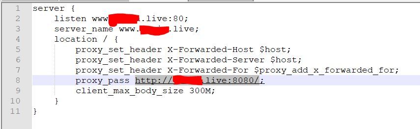

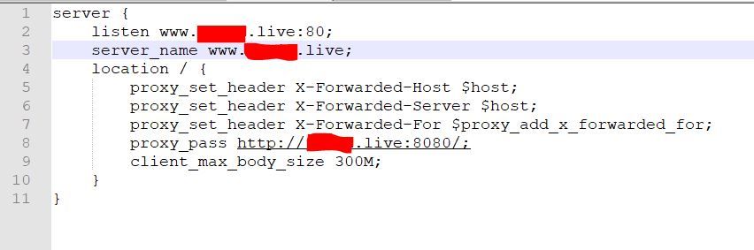

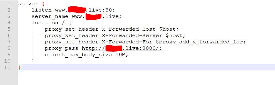

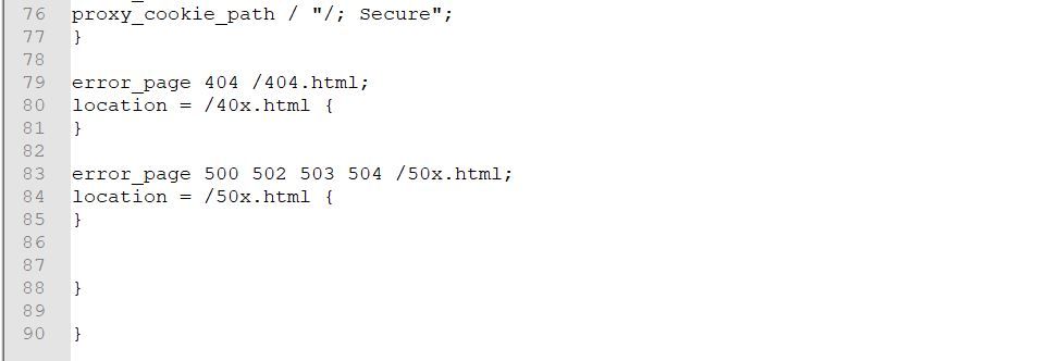

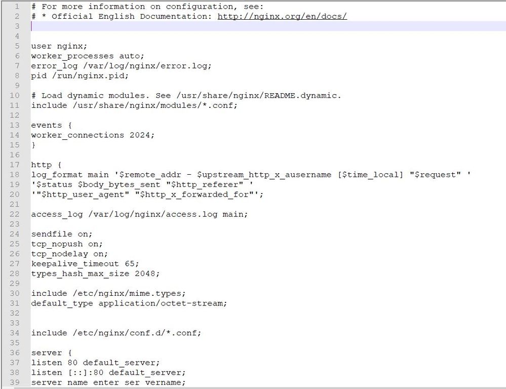

Here is my /etc/nginx/conf.d/default.conf file

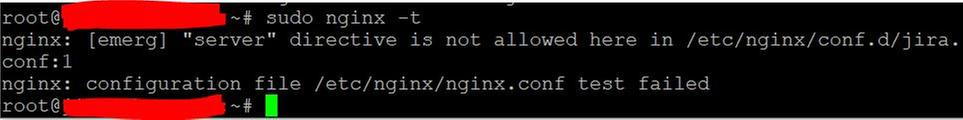

server {
listen www.[hostname].xyz:80;
server_name www.[hostname].xyz;
location /jira {
proxy_set_header X-Forwarded-Host $host;
proxy_set_header X-Forwarded-Server $host;
proxy_set_header X-Forwarded-For $proxy_add_x_forwarded_for;
proxy_pass http://[hostname].xyz:8080/jira;
client_max_body_size 10M;
and here is my jira config file /opt/atlassian/jira/conf/server.xml
but here are my queries now
1. I want to install https certificate from lets encrypt. I installed certbot for that and upon running certificate install command below is the error I am getting
Do I need to do something before running certificate install command for nginx? Do I need to change server block in /etc/nginx/conf.d/default.conf file?
2. I want to get rid of /jira from URL. Is it possible?

In the the server.xml  you need to change the context path look for this  line
Current
<Context path="/jira" docBase="${catalina.home}/atlassian-jira" reloadable="false" useHttpOnly=true >
After change
<Context path="" docBase="${catalina.home}/atlassian-jira" reloadable="false" useHttpOnly=true>

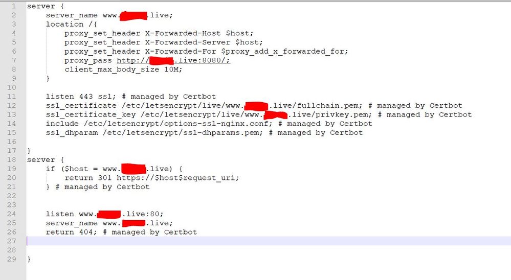

in the /etc/nginx/conf.d/default.conf  remove jira in the server block so you will have the below
  server {
location / {
proxy_pass http://[hostname].xyz:8080/;
Restart Nginx and JIRA successfully running via reverse proxy, access JIRA  via  https  link  and  the configure  the  BASE URL,  which will allow access this link only. i.e
https://[myhostname].xyz/secure/Dashboard.jspa

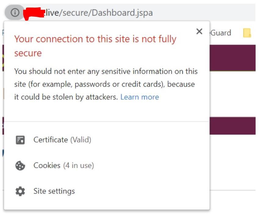

1) for installing https certificate
I am using certbot to install let's encrypt https certificate and domain registrar is godaddy. I own the domain name and I have created A record as well in my private cloud server control panel. Still I am getting this error while installing https cert and i guess let's encrypt does not support godaddy.
Let's say I will work around this then question is
"after installing https certificate, what kind of config changes do I need to do in
/opt/atlassian/jira/conf/server.xml  file and in /etc/nginx/conf.d/default.conf file "
can you just send me the lines to replace just like in above responses you sent and the file in which to do all these changes?

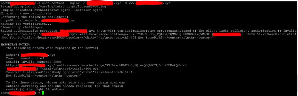

@Moses Thomas ,
I guess since I am using nginx as reverse proxy server, the acme challenge is failing while creating and installing certificate using below command
sudo certbot --nginx -d [hostname].xyz -d www.[hostname].xyz
Below url is kind of example as to what is happening more or less ( our nginx is reverse proxy server)
https://community.letsencrypt.org/t/the-client-lacks-sufficient-authorization-404/5309
Can you please give me proper config changes in such a way that it will allow acme challenge to pass. The url it is trying to reach is as below
http://[hostname].xyz/.well-known/acme-challenge/RUGLFcgi4PvP63zu-gt5_kf_aG7_Pqax1yNK7UdfVtk
If I put a simple html file in above location then I can not access it in browser. it gives me 404.
http://[hostname].xyz/.well-known/acme-challenge/abc.html
I created /.well-known/acme-challenge/abc.html in /var/atlassian/application-data/jira/ folder and also in /var/www/html/ folders but I could not access abc.html using below url
So I guess we have to do some changes in config so that it allows access to
http://[hostname].xyz/.well-known/acme-challenge/*
Let me know your thoughts.
Regards,
M

We are almost done, Regarding 1 point Before we continue with further configuration of nginx, let us fix problem with generating certificate using cerbort.
When you ping your domain by typing
ping domain_name   /On the terminal
Which IP address do you obtain? and make sure you are typing the correct domain name,
Now the "error" say make sure we are typing the domain correctly and the DNS A/AAAA records for the domain contain the right IP
This means A/AAAA records are IPV4/IPV6 addresses; the IP address you have obtained from ping is it the same as the IP address in the DNS ZONE
check the domain manager make sure they are the same, i suppose it should be A record IPv4(address)
You can also check cat /etc/resolv.conf to see the Domain name and IP adress and the A record(Domain's IP) is the same as host IP address
change default.conf  to
server {
    listen 80 default_server;
    listen [::]:80 default_server;
    root /var/www/html;
    server_name  [hostname].xyz www.[hostname].xyz;
After verifying this then try to regenerate using
and check whether cerbort works  later we will modify  default.conf and nginx.conf    to suit our needs.

Since I was kind of in hurry, here is what I tried and it worked
https://certbot.eff.org/lets-encrypt/ubuntubionic-nginx
I followed all steps mentioned in default tab and it worked and
Now I have successfully installed certificate and I can access jira as
https://www.[myhostname].live
(P.S. i have changed .xyz to .live)
Here is how my /etc/nginx/conf.d/default.config file looks now
these changes in nginx config file are done by certbot only.
querries
1. what changes do I need to do in jira server.xml or in any other config file to make compatible for https?
2. On home page I see this error instead of https lock icon
3. If I log in then on some pages the error in point 2 goes away and it displays lock icon.
4. some links are giving me 404 after loggin in (e.g. if I click on issue then it gives 404)
http://[myhostname].live/browse/INT-6
I also don't know why those urls are still http
5. images are loading using http hence not loading
I guess these all are related to jira config for https.
Please guide me on this.

@mdesai  OK good  this is good i will send you two  final files. but please change  Base url   the link you use to access jira via https https://www.[myhostname].live
You need to have the system administrator global permission in order to perform this function.
To configure the Base URL:
Choose > System.
Choose General Configuration in the left-hand panel.
Choose Edit Settings.
Enter the new URL in the Base URL text box.
Choose Save.
After this  check to see if all links are ok

nginx.conf
# For more information on configuration, see:
# * Official English Documentation: http://nginx.org/en/docs/
user nginx;
worker_processes auto;
error_log /var/log/nginx/error.log;
pid /run/nginx.pid;
# Load dynamic modules. See /usr/share/nginx/README.dynamic.
include /usr/share/nginx/modules/*.conf;
events {
worker_connections 2024;
http {
log_format main '$remote_addr - $upstream_http_x_ausername [$time_local] "$request" '
'$status $body_bytes_sent "$http_referer" '
'"$http_user_agent" "$http_x_forwarded_for"';
access_log /var/log/nginx/access.log main;
sendfile on;
tcp_nopush on;
tcp_nodelay on;
keepalive_timeout 65;
types_hash_max_size 2048;
include /etc/nginx/mime.types;
default_type application/octet-stream;
#include /etc/nginx/conf.d/*.conf;
server {
server_name enter_ser_vername;
# Load configuration files for the default server block.
#include /etc/nginx/default.d/*.conf;
rewrite ^ https://$server_name$request_uri? permanent;

server {
listen 443 ssl http2 default_server;
listen [::]:443 ssl http2 default_server;
server_name enter_server_name;
ssl_certificate "/etc/letsencrypt/live/example.com/fullchain.pem";
ssl_certificate_key "/etc/letsencrypt/live/example.com/privkey.pem";
ssl_session_cache shared:SSL:1m;
ssl_session_timeout 10m;
ssl_protocols TLSv1.2 TLSv1.3;
ssl_ciphers ' ECDHE-ECDSA-AES128-GCM-SHA256:ECDHE-RSA-AES128-GCM-SHA256:ECDHE-ECDSA-AES256-GCM-SHA384:ECDHE-RSA-AES256-GCM-SHA384:ECDHE-ECDSA-CHACHA20-POLY1305:ECDHE-RSA-CHACHA20-POLY1305:DHE-RSA-AES128-GCM-SHA256:DHE-RSA-AES256-GCM-SHA384';
ssl_prefer_server_ciphers off;
ssl_dhparam /etc/nginx/ssl/dhparams.pem;
add_header Strict-Transport-Security "max-age=63072000" always;
location / {
client_max_body_size 300m;
if ($request_uri ~* "(/.*)")
proxy_pass http://localhost:8080$1; break;
proxy_pass http://localhost:8080;
proxy_cookie_path / "/; Secure";
error_page 404 /404.html;
location = /40x.html {
error_page 500 502 503 504 /50x.html;
location = /50x.html {

Hi @Moses Thomas
Thanks again for your quick response.

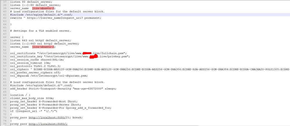

Here is my /etc/nginx/conf.d/jira.conf file

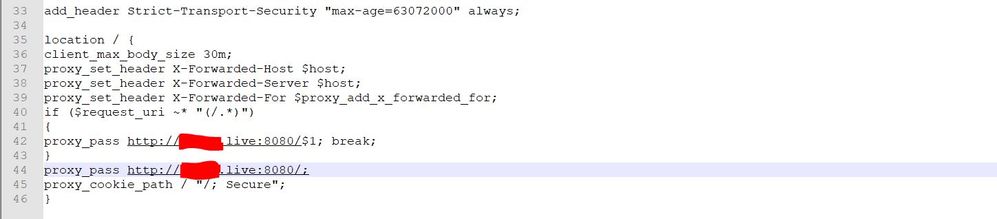

Here is my /etc/nginx/nginx.conf file
After doing these changes I am not able to restart nginx. if I run the command
sudo nginx -t
it gives below output
P.S. I have removed /etc/nginx/conf.d/default.conf file and now inside /etc/nginx/conf.d directory, there is just one file jira.conf
Thanks again.
Regards,
M
Moses Thomas
May 12, 2020
@mdesai  Sorry my bad i have updated the nginx.conf  lots where missing when i modified/ copied. Check it again
nginx -t && nginx -s reload
restar nginx,   I hope it will work this time.
mdesai
May 13, 2020
Hi @Moses Thomas
Still the error as below:
Thanks & Regards,
-M

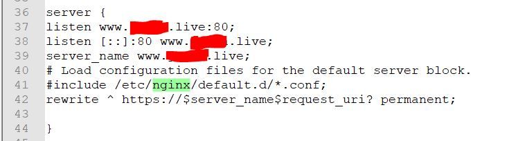

I have done below change
before:
after:
listen www.[myhostname].live:80;
listen [::]:80 www.[myhostname].live;
there is something wrong in above 2 lines. I just made "listen" to be like my default.conf
let me know
Regards,
-M

@mdesai  Don't mixed it up, look at the  ngnix.conf  i have provided ,  it should be the same with yours.
The error says line 38  and  in your current file its not same with the one i presented  because if your have it like i have provided it can not say invalid parameter  since  the below is not present in line 38
listen [::]:80 www.xyz.live;
should be the below

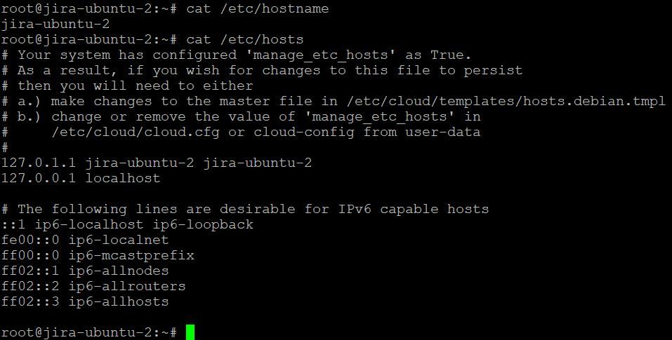

If  you ping  server name and  its working i.e it should be working without problems
and please show me what you have in  cat /etc/hostname  and cat /etc/hosts

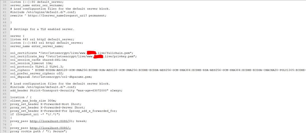

mdesai
May 13, 2020
@Moses Thomas  ohh ok, my bad. I thought I am supposed to do below changes
6. change server_name, (ssl_certificate,ssl_certificate_key, ssl_dhparam) paths to be the same as default.conf i ask to copy some where safe.
7. Lastly change listen, server_name, proxy_pass to be the same as in the default .conf.
in jira.conf and nginx.conf files. Sorry i misunderstood.

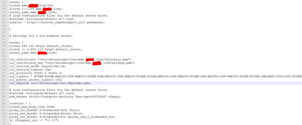

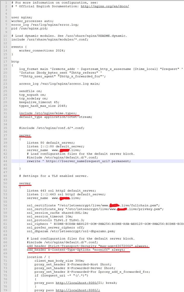

Here is my /etc/nginx/nginx.conf file now (copied your nginx.conf file only )
The only changes I have done in your nginx.conf file are ssl_certificate, ssl_certificate_key, ssl_dhparam which you can see above on line 53,54 and 60
The test has been successful now.
Here is output of cat /etc/hostname  and cat /etc/hosts

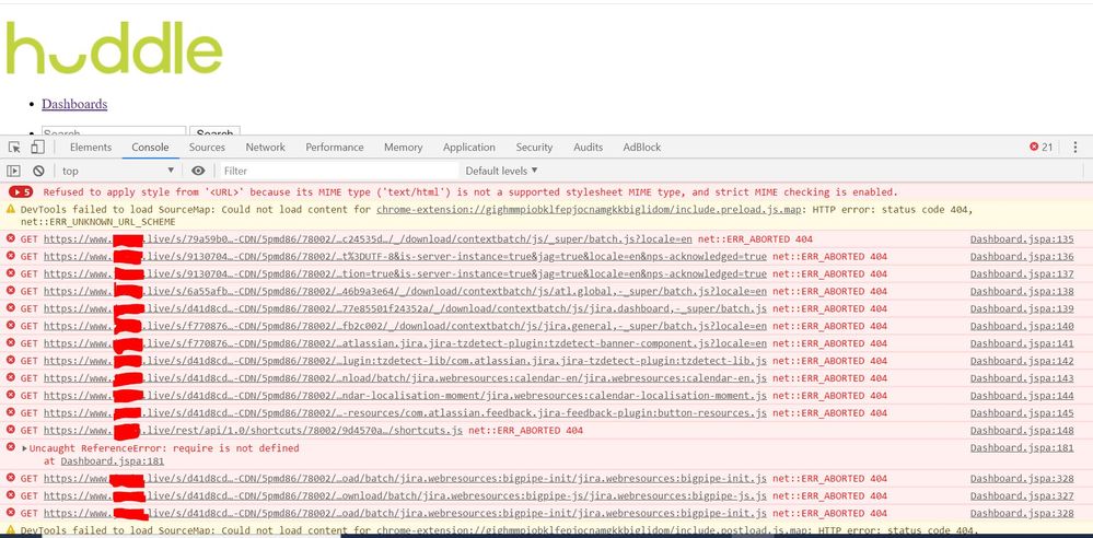

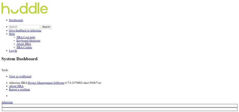

Also, I am getting below issue in frontend
it seems like css files are not loading.
P.S. I have also changed the base url from backend to be https://www.[myhostnamr].live/
Kind regards,
-M

Your server_name  is   jira-ubuntu-2,    so change  server_name in  nginx.conf    and comment out

mdesai
May 13, 2020
@Moses Thomas
ok. got it. but even after those changes there is still something wrong.
sudo nginx -t && nginx -s reload       runs successfully but when I visit the url
then it gives me 404 not found
and here is my jira.conf file now. Note that the server_name in jira.conf is
www.[hostname].live which it taken from my previous default.conf file.

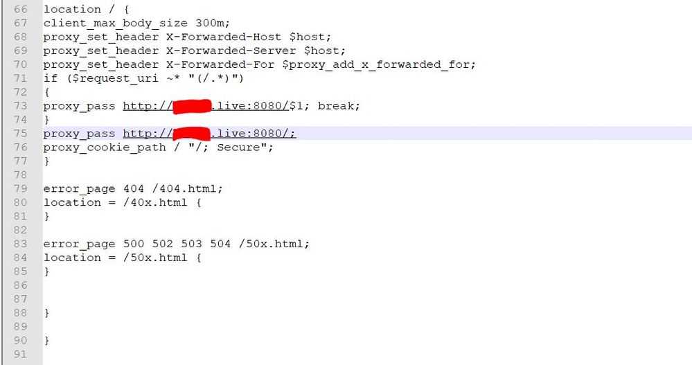

Here is my nginx.conf file now. I have highlighted server_name variable value in it.
Regards,
-M

mdesai
May 13, 2020
@Moses Thomas
yes I forgot the include line to comment out. I did that and removed jir.conf file and restarted jira and nginx but it is still not working.
if I type url
https://www.[myhostname].live/
in chrome then it takes me to
https://jira-ubuntu-2/startup.jsp?returnTo=%2Fdefault.jsp
here is nginx.conf
Regards,
-M

mdesai
May 13, 2020
@Moses Thomas
really appreciate that.
I changed the server_name to www.[hostname].live
it worked now. the only issue is css not loading
-M

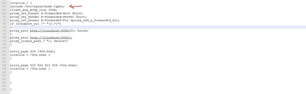

Moses Thomas
May 13, 2020
@mdesai
first try;
move   include /etc/nginx/mime.types;   to
location /{
mdesai
May 13, 2020
@Moses Thomas
ok..did it. still the same result. css is not loading.

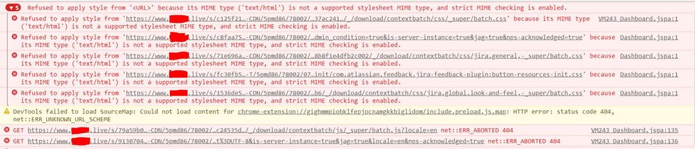

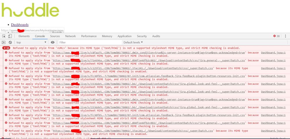

Moses Thomas
May 13, 2020
@mdesai  I once had this problem before but i don't recall how i  solve it hmm
* Take include /etc/nginx/mime.types; back to where it was and then reorder these
to have the below and then try
* If it does not work, check firewall and appamour make sure they are not block anything (you may disable temporarily and try)
* Clear web browser( so we can rule out cache issue)
* Press F12 on the web browser and on the console check errors found.
* Show also /var/log/nginx/error.log may be we could find some information there
* You may try to reboot the server ( "most likely useless)
mdesai
May 13, 2020
@Moses Thomas
I tried all suggestions but none of them worked. still the same issue

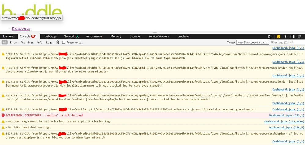

Here is F12 console errors:
and here are the error.log details:
2020/05/13 20:03:29 [notice] 14786#14786: signal process started
2020/05/13 20:06:34 [notice] 15263#15263: signal process started
2020/05/13 20:07:02 [error] 15287#15287: *1 recv() failed (104: Connection reset by peer) while reading response header from upstream, client: 24.188.37.96, server: jira-ubuntu-2, request: "GET / HTTP/2.0", upstream: "http://127.0.0.1:8080//", host: "www.[mydomainname].live"
2020/05/13 20:07:02 [error] 15287#15287: *1 open() "/usr/share/nginx/html/50x.html" failed (2: No such file or directory), client: 24.188.37.96, server: jira-ubuntu-2, request: "GET / HTTP/2.0", upstream: "http://127.0.0.1:8080//", host: "www.[mydomainname].live"
2020/05/13 20:07:03 [error] 15287#15287: *1 connect() failed (111: Connection refused) while connecting to upstream, client: 24.188.37.96, server: jira-ubuntu-2, request: "GET /favicon.ico HTTP/2.0", upstream: "http://127.0.0.1:8080//favicon.ico", host: "www.[mydomainname].live", referrer: "https://www.[mydomainname].live/"
2020/05/13 20:07:03 [error] 15287#15287: *1 open() "/usr/share/nginx/html/50x.html" failed (2: No such file or directory), client: 24.188.37.96, server: jira-ubuntu-2, request: "GET /favicon.ico HTTP/2.0", upstream: "http://127.0.0.1:8080//favicon.ico", host: "www.[mydomainname].live", referrer: "https://www.[mydomainname].live/"
2020/05/13 20:13:45 [notice] 15791#15791: signal process started
2020/05/13 20:20:10 [error] 16029#16029: *183 upstream prematurely closed connection while reading upstream, client: 24.188.37.96, server: www.[mydomainname].live, request: "GET /static-assets/metal-all.css HTTP/2.0", upstream: "http://127.0.0.1:8080//static-assets/metal-all.css", host: "www.[mydomainname].live", referrer: "https://www.[mydomainname].live/issues/"
2020/05/13 20:20:10 [error] 16029#16029: *183 upstream prematurely closed connection while reading upstream, client: 24.188.37.96, server: www.[mydomainname].live, request: "GET /static-assets/metal-all.js HTTP/2.0", upstream: "http://127.0.0.1:8080//static-assets/metal-all.js", host: "www.[mydomainname].live", referrer: "https://www.[mydomainname].live/issues/"
2020/05/13 20:50:51 [notice] 16365#16365: signal process started
2020/05/13 20:52:25 [error] 16386#16386: *1 upstream timed out (110: Connection timed out) while reading response header from upstream, client: 24.188.37.96, server: www.[mydomainname].live, request: "GET /secure/BrowseProjects.jspa HTTP/2.0", upstream: "http://127.0.0.1:8080//secure/BrowseProjects.jspa", host: "www.[mydomainname].live", referrer: "https://www.[mydomainname].live/secure/Dashboard.jspa"
2020/05/13 20:52:25 [error] 16386#16386: *1 open() "/usr/share/nginx/html/50x.html" failed (2: No such file or directory), client: 24.188.37.96, server: www.[mydomainname].live, request: "GET /secure/BrowseProjects.jspa HTTP/2.0", upstream: "http://127.0.0.1:8080//secure/BrowseProjects.jspa", host: "www.[mydomainname].live", referrer: "https://www.[mydomainname].live/secure/Dashboard.jspa"
2020/05/13 21:30:57 [notice] 17008#17008: signal process started
2020/05/13 21:32:30 [error] 17245#17245: *1 upstream timed out (110: Connection timed out) while reading response header from upstream, client: 24.188.37.96, server: www.[mydomainname].live, request: "GET /secure/Dashboard.jspa HTTP/2.0", upstream: "http://127.0.0.1:8080//secure/Dashboard.jspa", host: "www.[mydomainname].live"
2020/05/13 21:32:30 [error] 17245#17245: *1 open() "/usr/share/nginx/html/50x.html" failed (2: No such file or directory), client: 24.188.37.96, server: www.[mydomainname].live, request: "GET /secure/Dashboard.jspa HTTP/2.0", upstream: "http://127.0.0.1:8080//secure/Dashboard.jspa", host: "www.[mydomainname].live"
2020/05/13 21:36:05 [error] 17245#17245: *109 upstream prematurely closed connection while reading upstream, client: 66.249.64.92, server: www.[mydomainname].live, request: "GET /robots.txt HTTP/1.1", upstream: "http://127.0.0.1:8080//robots.txt", host: "www.[mydomainname].live"
2020/05/13 21:42:30 [notice] 1425#1425: signal process started
I have also rebooted the server but it didn't work either.
Regards,
-M

change back the order  as below

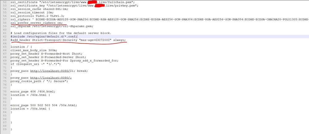

comment out the below   "i am suspecting this guy here"  we don't need strict check
and  change the below to  "on"
And try i hope it works  other wise i  have to  heavily cross check this configuration may be we will need to have a  call or something.
mdesai
May 13, 2020
@Moses Thomas
ok. I really appreciate your efforts! You are the best support I have ever had. Thanks!

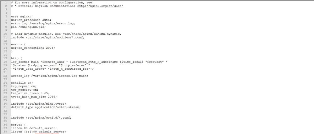

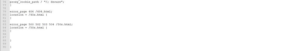

I tried it but it still did not work. Below are the changes done in nginx.conf
Regards,
-M

@mdesai
After reading the  X-Content-Type-Options    it  seem we need to add point2  in  the server block in  nginx.conf  change back   to
Point1
Point 2
add_header X-Content-Type-Options "nosniff" always;
 And verify  and restart nginx,  and check browser  with firefox, chrome ,opera
mdesai
May 14, 2020
@Moses Thomas
Still isn't working. same error in all browsers
P.S. there are 2 server blocks and I have added point 2 on second server block.
Correct me if I am doing something wrong.
Regards,
-M
Moses Thomas
May 14, 2020
@mdesai
This is interesting!
Exactly you are doing it correctly,  what error to  you get from other browser when you use F12 ?
mdesai
May 14, 2020
@Moses Thomas
opera
edge
mdesai
May 14, 2020

May 8, 2020
Hello @mdesai ,
Connection refused is either when there is a network level/port level restriction implemented from IT team. I would suggest you to check with your network admin is the port is blocked for any specific reason.
On you can try resting the IP table yourself.
http://insanelabs.net/linux/linux-reset-iptables-firewall-rules/
-Bibek
mdesai
May 8, 2020
Hi Bibek, Thanks for quick response. Actually I ran "ufw status" command and it is clearly showing that port 80 is allowed for ipv4 and ipv6 both. In many forums I went through, I found that after doing any changes in server.xml file on ubuntu., you have to restart jira service as root user. At the same time they have mentioned that running any service with root user on ubuntu is not safe. so what should be done in this case. any idea?
