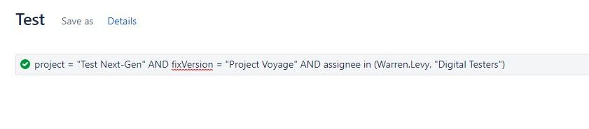

What I think you need to do is try copying everything after jql= and pasting it into the JQL filter editor within Jira, to ensure that the syntax is correct - see my example below. I think your syntax may be wrong, in terms of quotes - the editor will provide the correct quotes (if required) if you type it in manually.
Krk Rama Krishna
February 12, 2019
It is showing perfect results in the editor

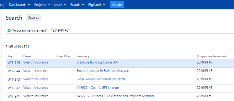

it's correct I believe I just copied and paste it, it does return the results on jira as you could see in my screen print above.

Yes it is definitely possible to filter on customfields. I've been playing around with your string and the # seems to be causing the issue.
For your API call, you need to change these :
  • Replace customfield_18625 with "Programme Increment" as per your screenshot.
  • Escape the # character with %23.
If that doesn't work, remove the # character and change = to ~

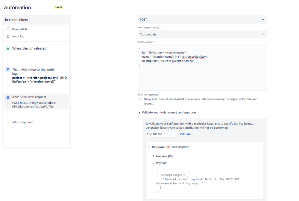

Abhishek Kalamkar
July 28, 2023
@Warren This below query is throwing error.  can we create dynamic filter using custom field and edit the permissions.
