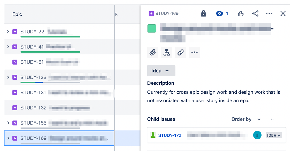

And create issues, often custom issues, from epics that we create via the roadmapScreenshot_2022-04-28_at_13_59_24.png

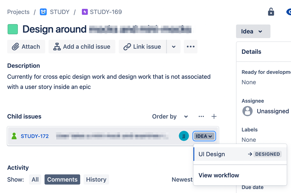

STUDY-172 is one such example, please note 'IDEA'

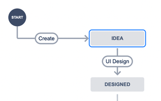

For completeness, of course 'IDEA' appears in the workflow

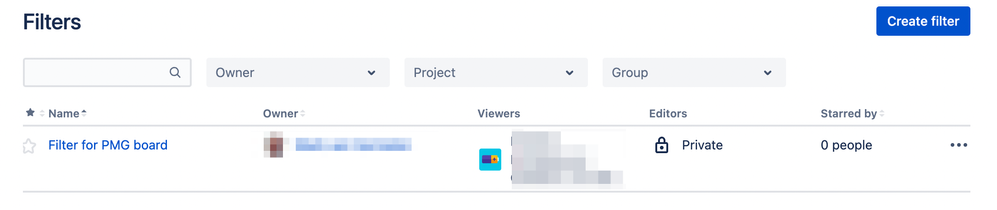

There are no filters applying to the STUDY board, we have one for a different board though

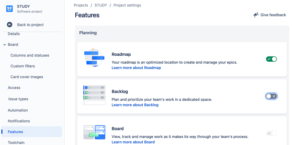

Thanks to Nic above I found the 'missing' issues in the Backlog, so
I clicked on Project settings
and then selected Features to reveal and turn off the Backlog setting
Once I had done that the missing issues turned up in the first column of the board
Bingo, desired effect.

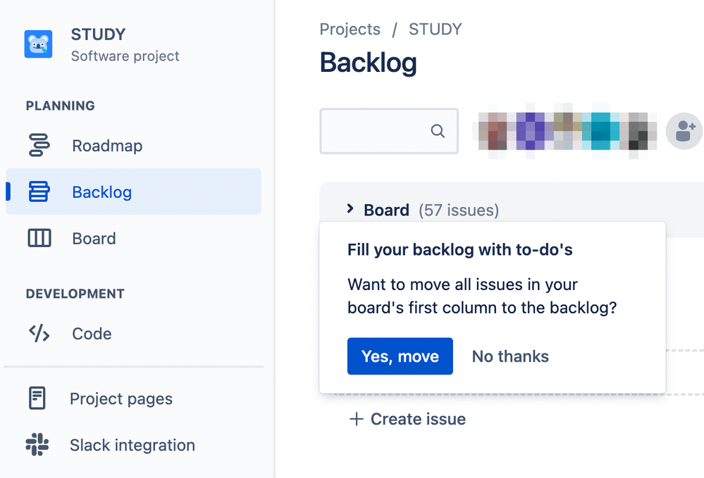

But being a tinkerer I found out that the backlog could be turned back on if needed, and a handy option appears on the backlog page
