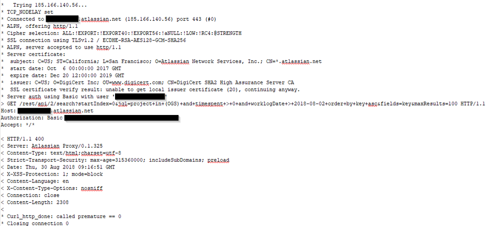

Today, 2018-08-30, I've launched the script and obtained an HTTP 400 return (bad request) with no change done on my script.
I thought first the authentication method changed, so I've done a new test using basic authentication with API token, but I've got the same result.
In the same time, calling the APIs from a browser, with same user logged, is working well.
Could you help me resolve this issue? Have there been any changes made on these APIs recently so that I would need to adapt the requests?

Hi Warren, after you answer I've check the worklog API, and it's working well.
Only search API is returning an error.
I think that Jira Devs have done some changes which have in consequence that my request is no more valid.
One or more characters of the request are now recognized as invalid, and that was not the case before...
HTTP Status 400 ÔÇô Bad Request
Type Exception Report
Message Invalid character found in the request target. The valid characters are defined in RFC 7230 and RFC 3986
Description The server cannot or will not process the request due to something that is perceived to be a client error (e.g., malformed request syntax, invalid request message framing, or deceptive request routing).

I think I've found the issue.
It seem that the JQL operator ">" is no more recognized as valid when making this API request via CURL.
When I change it to "=", it's working !
This request returns a HTTP 400 (bad request) :
curl_setopt($curl, CURLOPT_URL, "https://xxxxxxx.atlassian.net/rest/api/2/search?startIndex=0&jql=project+in+(OGS)+and+worklogDate+>+2018-08-02+order+by+key+asc&fields=key&maxResults=100");
This request returns a HTTP 200 (OK)
curl_setopt($curl, CURLOPT_URL, "https://xxxxxxx.atlassian.net/rest/api/2/search?startIndex=0&jql=project+in+(OGS)+and+worklogDate+=+2018-08-02+order+by+key+asc&fields=key&maxResults=100");

Fabrice Braccini August 31, 2018
Resolved with atlassian support.
When calling a REST API, if the request includes a JQL statement, this statement needs to be urlencoded without using the reserved syntax.
It was not needed before when using the reserved syntax, the "plus" character was accepted directly : "jql=project+=+OGS". This was working very well before, they didn't said it, but I think they've changed something.
So now I need to urlencode the statement without reserved chars, meaning a normal statement with "space" instead of "plus" chars  : "jql=project = OGS" which becomes "jql=project%20%3D%20OGS" urlencoded.
This works like a charm.
