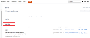

Regarding the new schemes created while creating a project, when you map existing scheme to the project, the new scheme will fall under inactive schemes. You can delete them.
Eldad Dayagi
February 28, 2023
@Rilwan Ahmed Thanks for the tips on how to create a project better next time.
In the screenshot you referred to workflow schemes and I was referring to issue type schemes, it doesn't seem that this Active/Inactive kind of separation exists for issue type schemes as it does for workflows but anyway it's also good to know so thanks again,

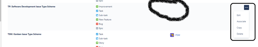

Rilwan Ahmed
March 1, 2023
Hi @Eldad Dayagi ,
You are right. For issue type schemes, there is no Active/Inactive.
The schemes show which projects it is assigned. If not assigned, then project column will be blank. Action menu will have delete link in it.
