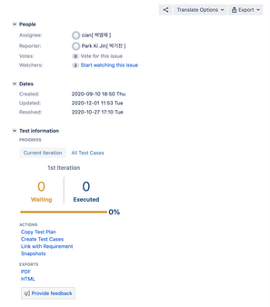

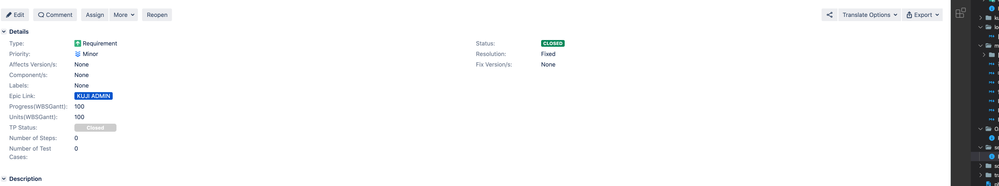

hi, Jira team.
When I clicked an issue before, a sider bar like the following picture is shown on the right.
But now this sidebar doesn't appear.. like this.
How can I fix it?

I will show my video. Whenever I refresh, the sidebar appears on the right and immediately disappears.
https://drive.google.com/file/d/1IydwSc12eWxrIfH7WZx_X_DcMqbNAIDy/view?usp=sharing
please help me.

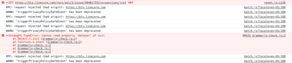

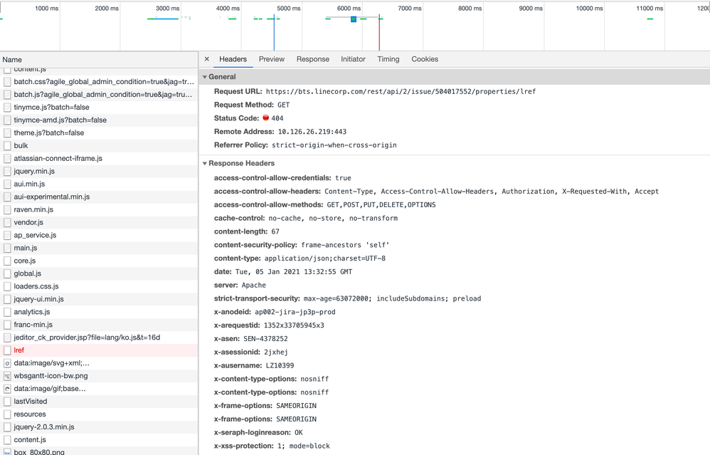

I have tried that. so, I found an API failed. is it the reason?
Using a different browser gives the same results(side-bar is gone), and using a different computer gives the same results.
I will attach a screenshot.
[console]
I am wondering if it is an app that you have installed that is causing the issue. Have you tried running is safe mode and seeing if the side bar comes back? https://confluence.atlassian.com/upm/disabling-and-enabling-apps-273875716.html
