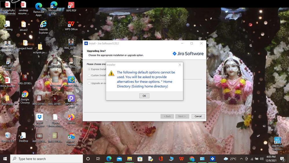

installation of jira in windows
nishant ranjan
December 9, 2021
when i click on express install during installation of jira then  i get  a message the following default options cant be used.please help.thanScreenshot (63).png
Fabio Racobaldo _Catworkx_
December 9, 2021
Hi @nishant ranjan ,
please provide us more information about your issue. Is the following issue your scenario https://jira.atlassian.com/browse/JRASERVER-25968 ?
Fabio
nishant ranjan
December 9, 2021
hi @Fabio Racobaldo _Catworkx_  i have attached the screenshot.please check.hope this will help to find more clue.thanx
December 9, 2021
you should enter the existing home directory when prompted. Did u try to click ok and go on with the task?
In this article https://confluence.atlassian.com/adminjiraserver/setting-your-jira-application-home-directory-938847747.html you can read
  • If you're using the Windows installer, you don't need to configure the Jira home directory separately, as you will be prompted to specify this location during the installation process.
  • The Jira installer may not be able to create the home due to permission problems. If this is the case, see Jira is unable to start due to 'Could not create necessary subdirectory'
