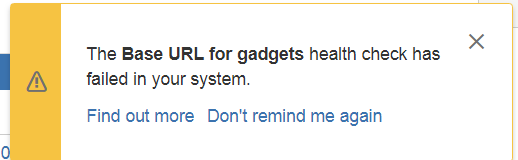

The base url error indicates that Jira cannot reach itself when it tests with the base url you have configured.
Check that you have entered the correct one under admin -> general configuration.  If you have, then you have a network error, it is set up incorrectly (this is likely to be the problem with the speed and probably the mail as well)

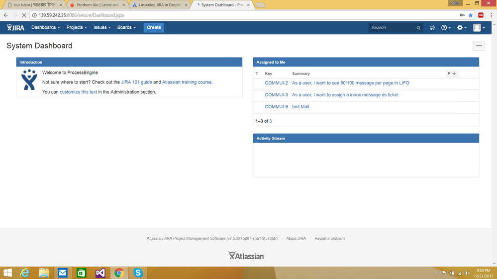

Dear, then how it come? please check below picture
Nic Brough -Adaptavist-
December 27, 2017
index.html would normally be returned by a wget that finds a web-server running there, not a running Jira.

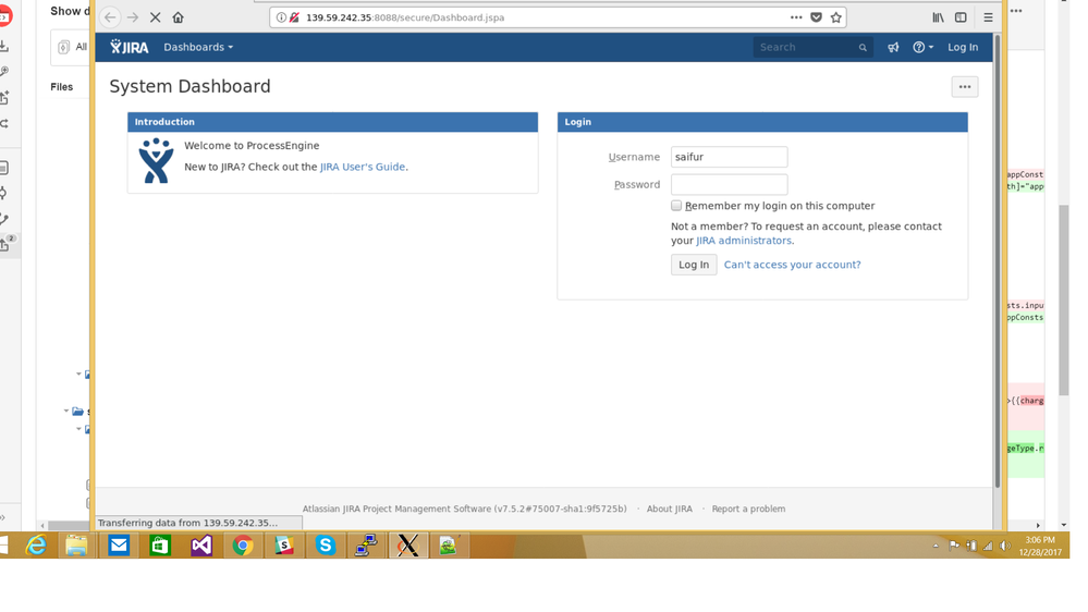

ranacse
December 28, 2017
Dear, here is Jira portal from server. Can you send me your mail address, so i can provide you index.html.JIRA.pngThanks
December 28, 2017
Ok, that's all correct.
I think we need a look at the log file to see what errors are coming back when it performs the check.
Also, is there a proxy involved?  Is that set up correctly?
