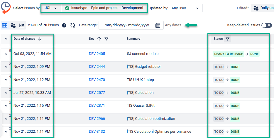

If you are open to trying add-ons, check out Issue History for Jira developed by my team. You can filter by specific transition like "to Completed status" and create a report like the one below. You will get status transition history for every epic.
Welcome to the community !!
You can use Jira Rest API's and build your own custom solution or if you are open to explore mktplace apps for detailed and flexible reports, take a look at
The app shows the complete history of changes for your filtered issues with the ability to export as well.

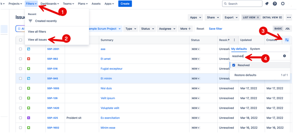

When an issue transitions to "Completed" status, issue resolution date is set by Jira itself. So what you are looking for is the "Resolved" field of the issue. While listing your issues, just add the "Resolved" column into your table report as can be seen on the screenshot below.

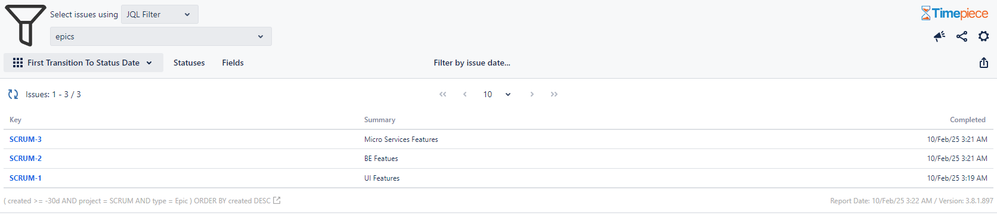

For a more detailed analysis, Timepiece – Time in Status for Jira provides reports that show exactly when an issue transitioned to a specific status. You can generate a First Transition to Status Date report to see the exact date an epic moved to "Completed."
Here's an example report:

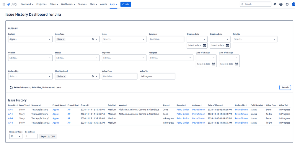

Then you write a JQL script to retrieve all issues that match your desired value for the created scripted field.
You filter for Issue Type- Epic, Updated Field - status and Value To - Completed.
If by any chance you are using Resolution to determine the completion, you search for Updated Field - Resolution instead.
The example below is using a Story and status but you can use Epic instead.
